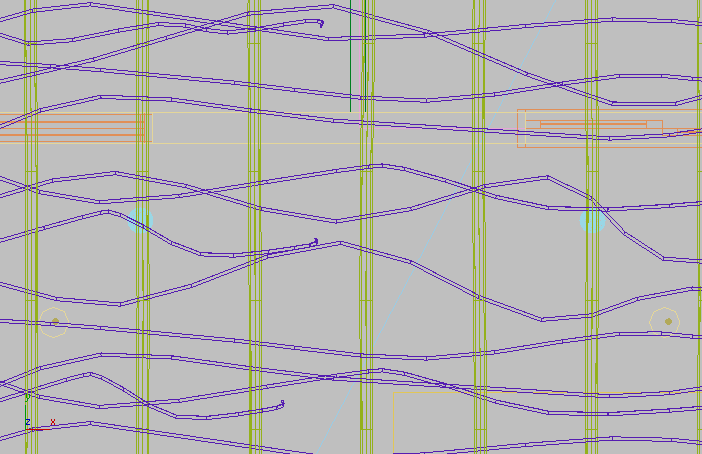

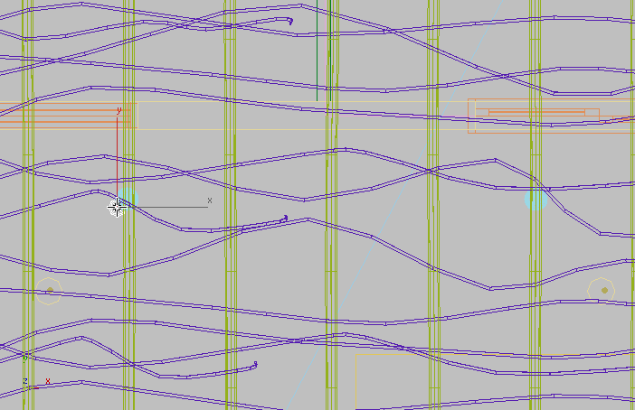

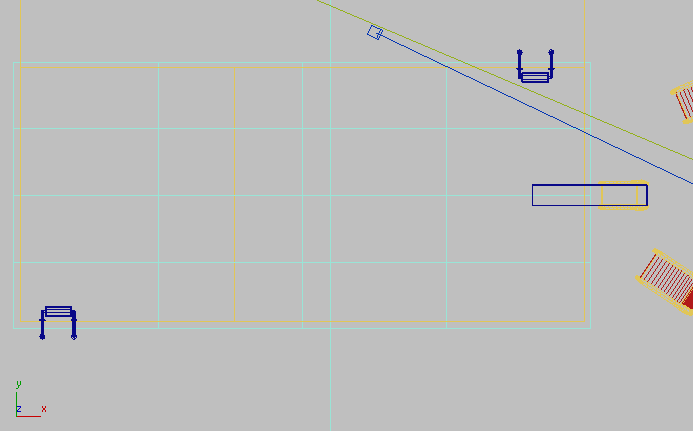

- Activate the Top viewport and
zoom in to the forward portion of the trellis, as shown in the next illustration.
There are three light fixtures in the ceiling of the lower porch. These appear as small circles in the wireframe view.
Zoom in farther to the fixture on the left.

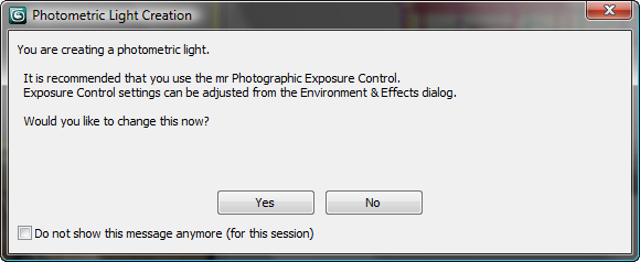

On the Object Type rollout, click Free Light to activate it.
3ds Max opens a dialog that asks whether to add an “mr Photographic Exposure Control” to the scene.
- Click Yes to add the exposure control.

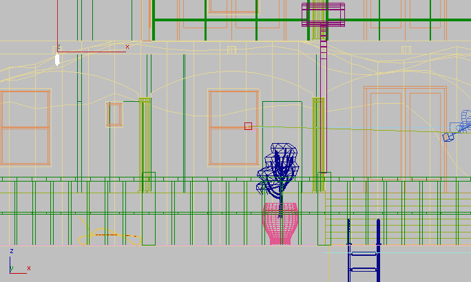

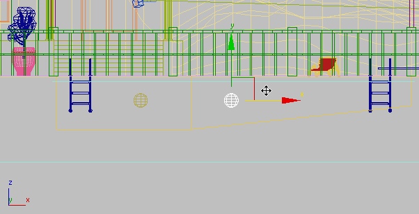

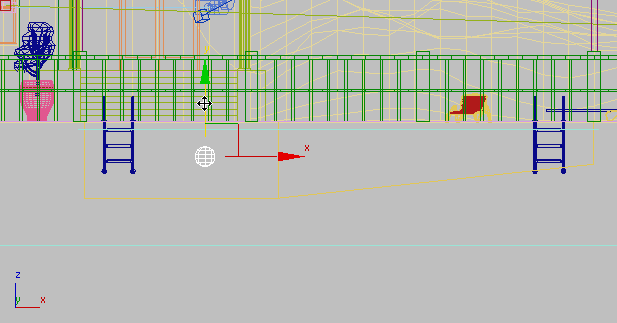

- Right-click the Front viewport, zoom in so you can see the light fixture socket and the new light object, and use
(Select And Move) to move the light object on its Y axis until it is positioned inside the fixture.

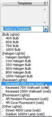

- Go to the

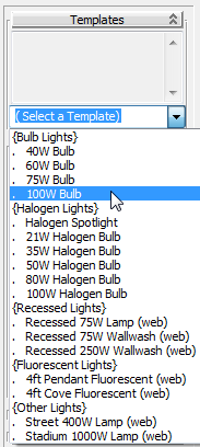

Modify panel. From the Templates rollout
Select A Template drop-down list, choose Recessed 75W Lamp (Web).
3ds Max updates values in the rollouts below the Templates rollout to match the real-world properties of a 75W incandescent light with uneven (web) distribution. You can adjust these properties, but for the present scene, we will use the template values.

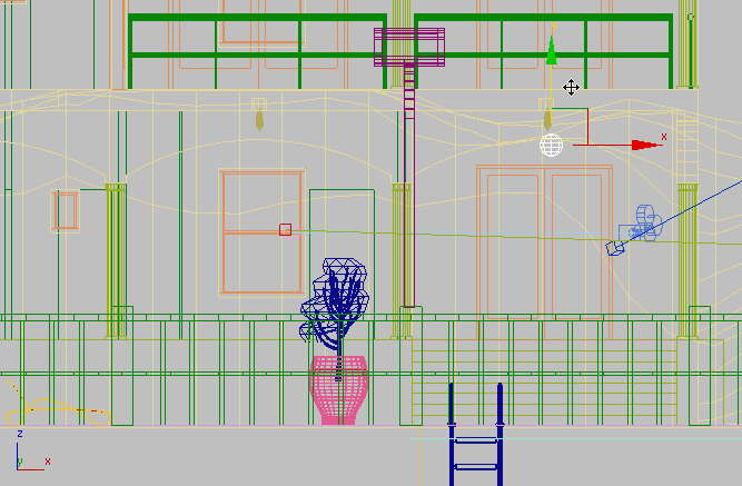

- In the Front viewport,
pan and
zoom out until you can see the porch light fixtures to the right of the light you just created.

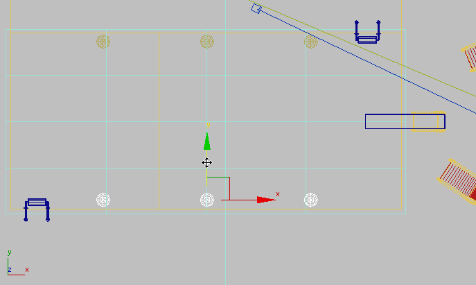

- Activate
(Select And Move), then Shift+drag a copy of the Free Light along its X axis until it is inside the neighboring socket, as shown in the next illustration.
3ds Max opens a Clone Options dialog. In the dialog
Object group, choose Instance. Set the Number Of Copies to 2, and then click OK.
3ds Max adds the other two porch lights. The third light has the same spacing you gave to the scond, so it lines up with the socket at the right.

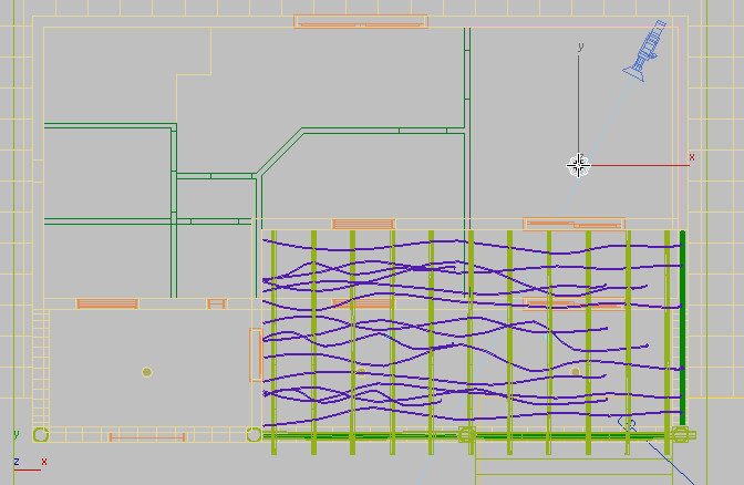

Add an interior light:

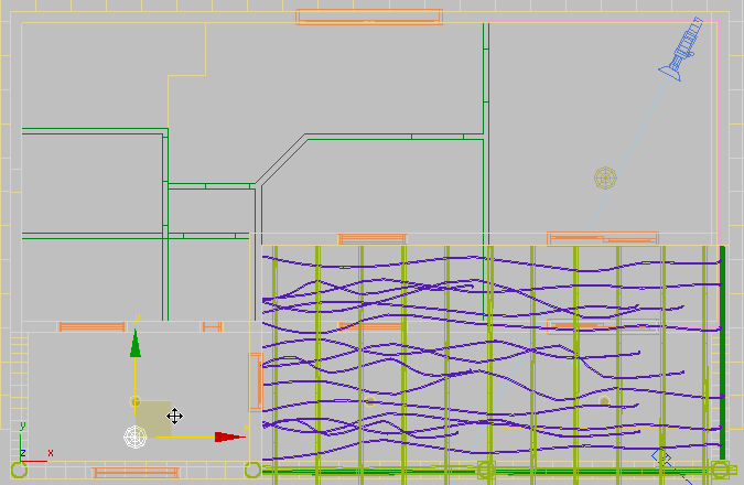

- Activate the Top viewport, then
zoom and
pan so you can see the plan of the house.
- On the
Create panel, activate
(Lights). On the Object Type rollout, click Free Light to activate it.
- Click once to create a light behind the door frame, as shown in the illustration, then right-click to end object creation.

- Go to the
Modify panel. On the Templates rollout, open the drop-down list and choose 100W Bulb.

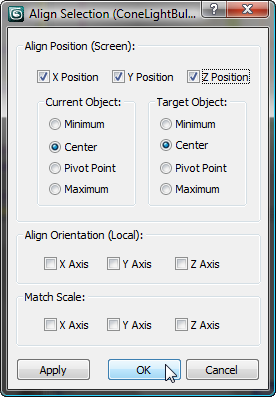

- On the main toolbar, click
(Align), then click ConeLightBulb01.
- In the Align Selection dialog
Align Selection (Screen) group, turn on X, Y, and Z Position, then choose Center for both Current Object and Target Object. Click OK.
This aligns the center of the light object with the light fixture.

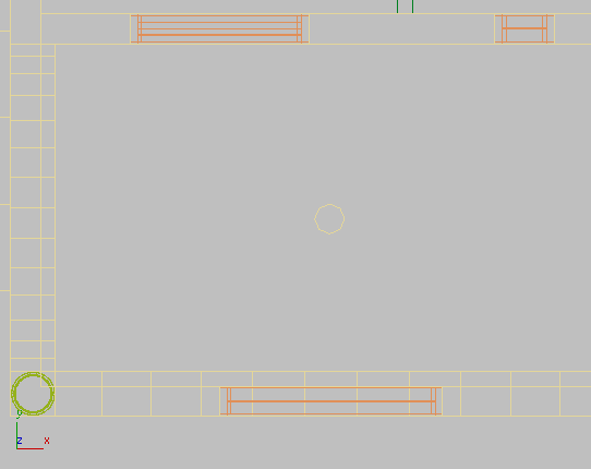

Add halogen lights to the pool:
zoom and
pan so you can see the swimming pool, as shown in the next illustration.
- On the
- Click once to place a light object at the inner edge of the pool on the upper-left side, as shown in the next illustration. Right-click to end object creation.
Be sure to position the light so it is slightly away from the pool wall.

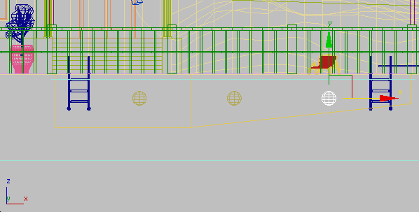

- Activate the Front viewport,
pan so you can see the swimming pool, then use
(Select And Move) to move the light object on its Y axis until it is positioned at the midpoint between the floor of the pool and the waterline.

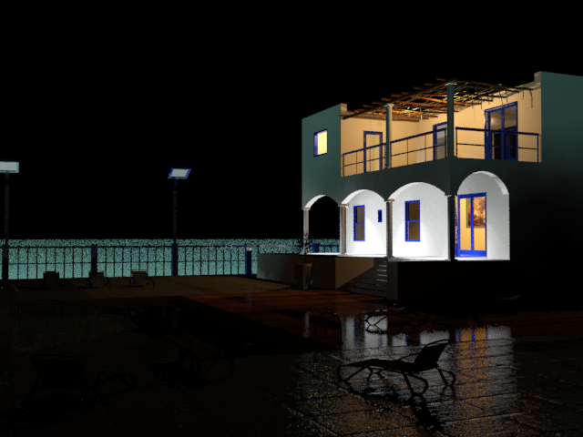

Render the villa with pool lighting:
- Restore the Rendered Frame Window, then make a
clone of the currently rendered frame.
- Activate the Camera-Terrace viewport,
render the scene, then compare the two renderings.
The scene is starting to take shape. Your next task will be to add light objects to the lamp posts that surround the pool.
