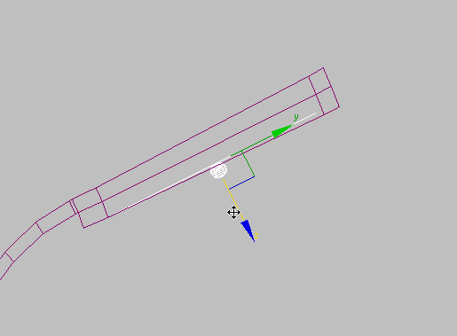

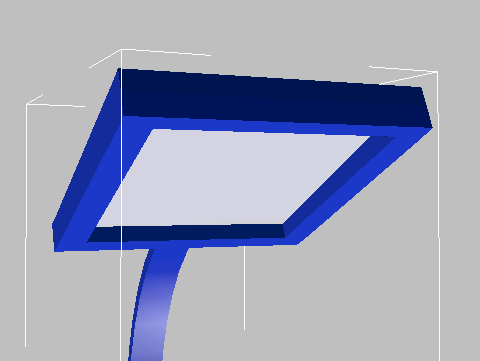

  8. On the Create panel, activate (Lights). On the Object Type rollout, click Free Light to activate it, and turn on AutoGrid.
  9. In the Perspective viewport, click once in the center of the light panel to place the light object on its surface. Turn off AutoGrid when you’re done.
Set the light properties:

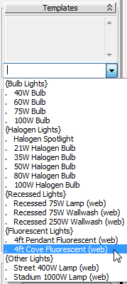

  1. Go to the Modify panel. On the Templates rollout, open the drop-down list and choose 4ft Cove Fluorescent (Web).
    By default, this type of object emits light as a point. However, you want the object to emit light in a rectangular area that corresponds to the geometry of the panel on the lamp post.

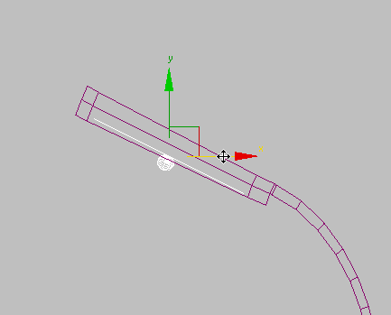

  2. In the Shape/Area Shadows rollout Emit Light From (Shape) group, choose Rectangle from the drop-down list.
  3. Drag the Length and Width spinner arrows until the rectangular bounding box matches the dimensions of the lamp post light panel.
    Use the Top and Left viewports to check your work. Use (Select And Move) to adjust the position of the light object if you need to.
  4. Activate the Front viewport.
  5. Activate (Select And Move).
  6. On the main toolbar, change the Reference Coordinate System to Local.
  7. Move the light object downward slightly, toward the lower surface of the fixture.
  8. Change the Reference Coordinate System back to View.

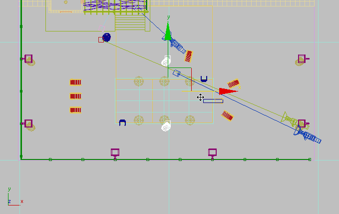

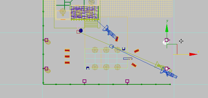

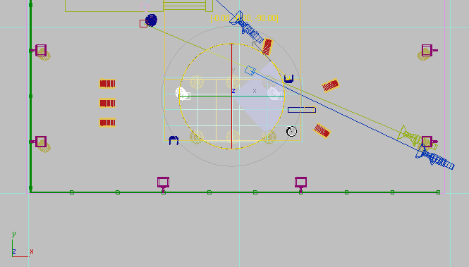

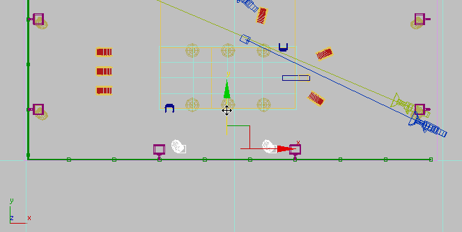

  1. Activate the Top viewport, press Shift+Z to return to the view of all six lamp posts, then use (Select And Move) to Shift+clone the light object to the neighboring lamp post, as shown in the next illustration. Make the cloned light an instance of the original.

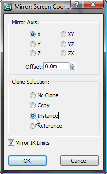

  2. In the Top viewport, Ctrl+click to select the first light (both deck lights should be selected), and then on the main toolbar, click (Mirror).
  3. In the Mirror dialog Mirror Axis group, make sure X is chosen. In the Clone Selection group, choose Instance and then click OK.
  4. In the Top viewport, move the cloned light objects to the lamp posts on the opposite side of the pool.
  5. Activate the Front viewport, and zoom in to the top of the lamp posts.
  6. Drag the two new lights along X axis until they approach the lower surface of the fixture.

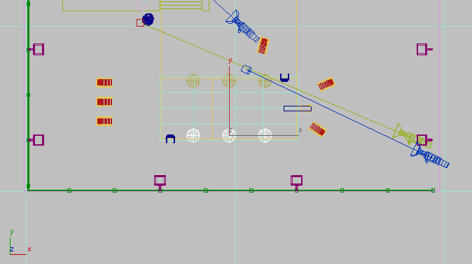

  1. In the Top viewport, Shift+clone the light objects to the mid point between the two remaining lamp posts, as shown in the next illustration. Make the clones instances, again.
  2. On the main toolbar, turn on (Angle Snap Toggle).
  3. Rotate the lights’ position by –90 degrees about the Z axis.
  4. Move the lights on their Y axis until they are in line with the two remaining lamp posts, as shown in the next illustration.
  5. Move each light individually on its X axis until the light is repositioned inside the corresponding lamp post.

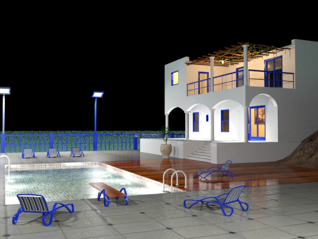

  1. Activate the Camera-Terrace viewport and render the scene.
    With the addition of these latest light objects, the time it takes to render the scene has increased considerably.
    The area around the pool is now illuminated, but the scene remains under-lit. The intensity of the fluorescent light objects needs some adjustment.

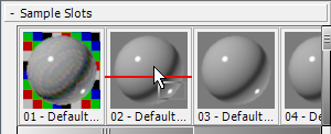

  3. In the Material/Map Browser panel on the left, navigate to the Sample Slots group.
  4. Drag the Camera Shaders Output button from the Render Setup dialog and drop it onto an unused sample slot. The sample slot shows a red bar across it when you are able to drop the map.

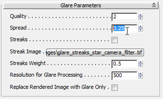

  8. On the Glare Parameters rollout, change the value of Spread from 2.0 to 0.25.
