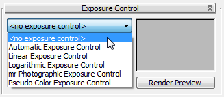

Set up exposure control:
- From the main menu, choose Rendering
Exposure Control. 3ds Max opens an Environment And Effects dialog.
- On the Exposure Control rollout, if the active exposure control is set to “mr Photographic Exposure Control” (mr is short for mental ray), then open the drop-down list and choose <no exposure control>.

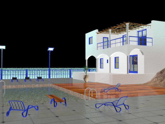

- Make sure the Camera-Terrace viewport is active, then
render the scene. Tip: You can press F9 as a shortcut for clicking Render Production.
With the exposure settings removed, you can now see the scene in a very basic way through default lighting.
The rendering appears flat and not very realistic. You need to add either man-made light sources or daylight to properly illuminate the scene. In this tutorial, you will create daylight by generating two mental ray photometric light sources:

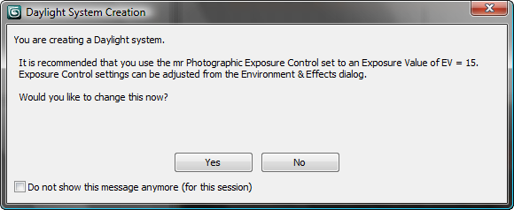

3ds Max opens the Daylight System Creation dialog, recommending an optimum exposure value for mental ray.
- Click Yes to accept the settings.

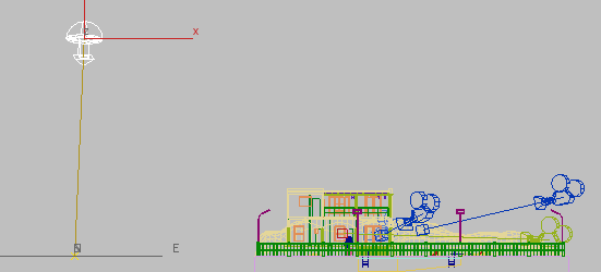

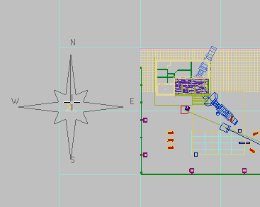

- In the Top viewport, click anywhere over the scene and drag slightly in any direction to create a compass rose.
- Release the mouse button.
- Move the mouse upward to position the sun object in the sky. You can use the Left viewport to see the sun object’s vertical positioning. The exact height of the sun object in the sky is not important.
- Click once to set the position of the sun, then right-click to end Daylight creation.

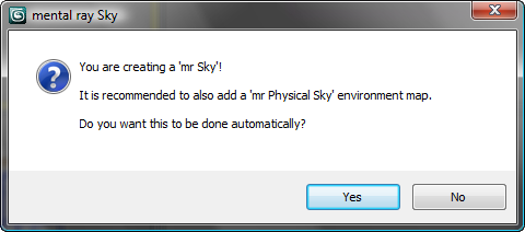

When you choose mr Sky 3ds Max opens the “mental ray Sky” dialog, which asks if you want to create an mr Physical Sky environment map.
Click Yes to add the environment map.

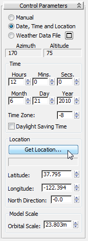

Set the time and location of the daylight:
Now you will reposition the sun object so its position in the sky corresponds to the geographic location of the scene.
- With the Daylight system (the sun object) still selected, in the Daylight Parameters rollout
Position group, click Setup.
3ds Max opens the
Motion panel.
- In the Control Parameters rollout
Location group, click Get Location.

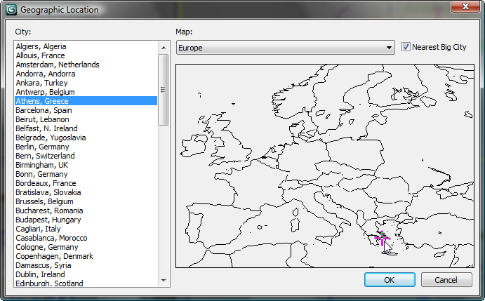

- On the Geographic Location dialog, choose Europe from the Map drop-down list.
- On the map, click on the country of Greece, or choose Athens Greece from the City list displayed at the left.
After you click OK, 3ds Max positions the Daylight sun object to model the real-world latitude and longitude of Athens, Greece.
The Control Parameters
Time group displays controls that let you modify the date and time of day, settings that also affect sun position. The scene you will illuminate and render is mid afternoon at 3 PM, or 1500 hours.
- In the Time group
Hours spinner, change the time to 15 (3 P.M.).
- In the Location group, set the North Direction to 345.0 degrees.
This adjustment orients the north-south position of the scene so the sun disc will appear over the sea as it prepares to set in the west.

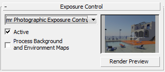

Set exposure:
- Choose Rendering
Exposure Control to display the Environment And Effects dialog.
- Make sure the Camera-Terrace viewport is active, then on the Exposure Control rollout, click Render Preview to quickly view the result in a thumbnail.
- The scene appears to be acceptable, so
render the Camera-Terrace viewport to get a better look.
The result is good, but the indoor regions, behind the windows and doorways of the villa, are darker than they should be. In the next lesson, you will learn how to solve this problem by taking some of the outdoor light and directing it into the building.
