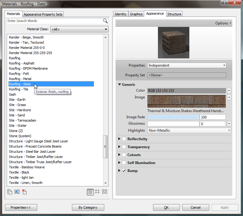

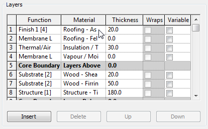

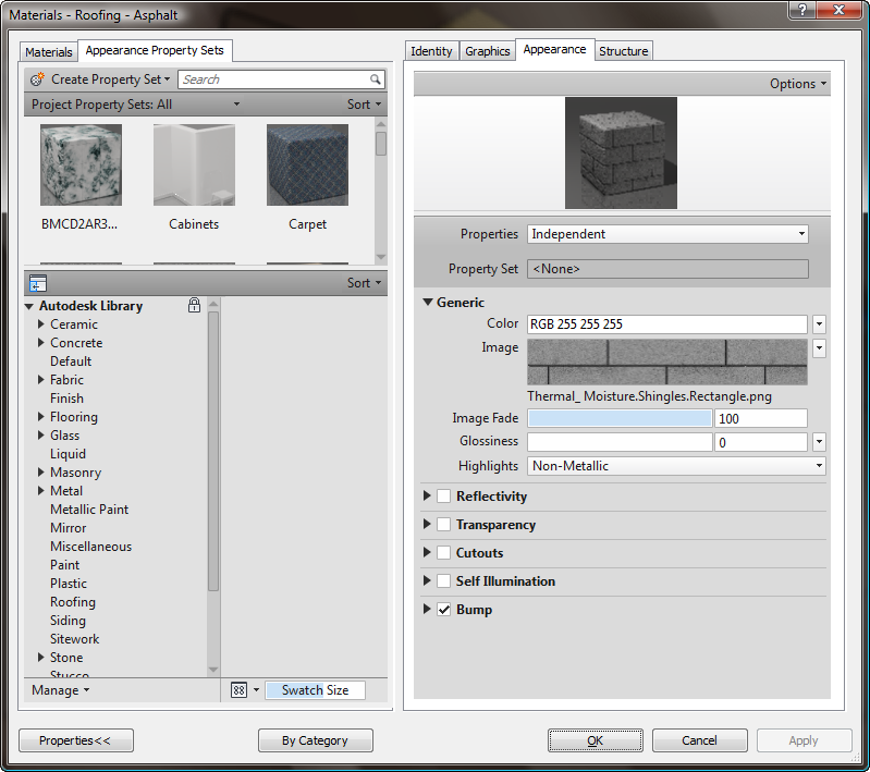

  4. In the Layers group Material column, click the top item in the list, Roofing - Asphalt.
    After you click the Roofing - Asphalt entry, a browser button appears. Click this button.
    Revit opens a Materials dialog.

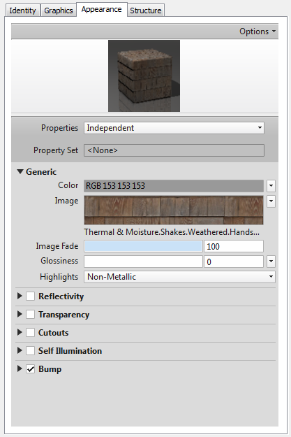

  5. On the Materials dialog, click the Appearance tab to display a thumbnail of the roof shingle material.
  6. In the Materials tab at the left, scroll down in the list of materials and choose Roofing - Slate.
    Note: If this material is not available on your system, choose an alternate material.
  7. Click OK on all the open dialogs to exit the material edit controls.
    The texture and mapping coordinates of your selected material will be properly transferred to 3ds Max, with no further intervention required on your part.

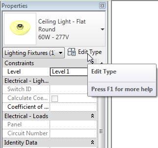

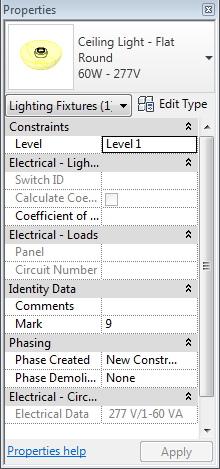

  3. Click to select any ceiling light object in the scene.
    Revit displays a description of the light object in the Properties panel to the left.
  4. On the Properties panel, click Edit Type.
    Revit opens a Type Properties dialog.
  5. On the Type Properties dialog Type Parameters group, scroll down to the Photometrics rollout and review the parameters displayed.
    These values, particularly Initial Intensity and Color, will affect the rendered result in 3ds Max, so be sure these parameters contain the result you are looking for. (You can later update these values in 3ds Max, if you need to.)

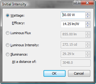

  6. Click the Initial Intensity button to view more detail on light intensity.
    Note: 3ds Max uses Lumens rather than Watts to measure light intensity. When a Revit scene is imported into 3ds Max, all wattage is converted into Lumens, but intensity of the light object is not affected.
  7. Click OK to exit the dialogs.

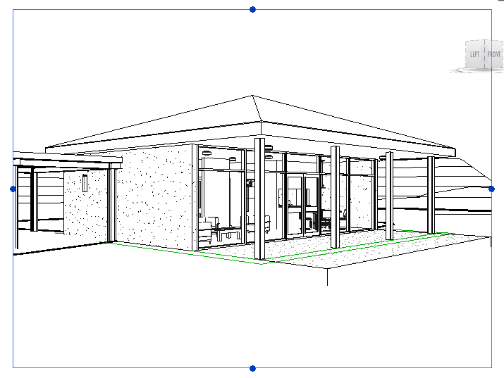

Create a camera:
    By default, the 3D view in Revit uses an isometric perspective, but in 3ds Max rendering, we work with camera views. In this procedure, you create a camera for an exterior viewpoint.
    Note: You can create multiple cameras in Revit. When you link to a Revit file, 3ds Max prompts you for which camera view to use.
  1. In the Project Browser panel, navigate to Views Floor Plans and double-click Level 1.
  2. Zoom so you have a view of the house and the area around it.
  3. On the ribbon, go to the View tab.
  4. On the Create panel, open the 3D View drop-down list, and choose Camera.

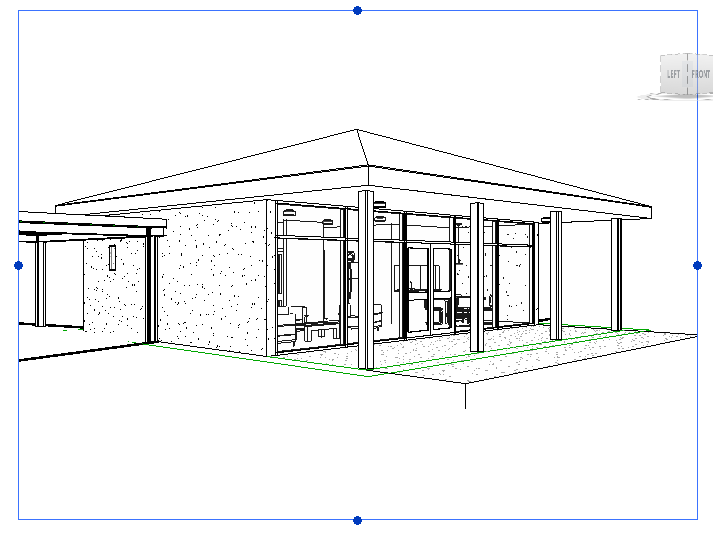

  5. Place the camera by clicking below the reference object at the left of the scene, then click a point along the front wall of the house, to the left of the double doors.
    Revit creates a camera view. This is the view you will initially use to render your image in 3ds Max. It also changes the ribbon to show the Modify | Cameras tab.

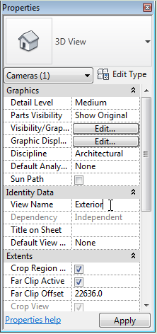

  6. On the Properties panel at the left, in the Identity Data rollout View Name field, change the name of the camera to Exterior, then click Apply (or press Enter).
  7. Also on the Properties panel, scroll down to the Extents rollout. Turn off Far Clip Active.
    After a pause, the view shows hills in the distance.
    Tip: If the hills in the distance don't appear interactively, click Apply.
    With Far Clip Active turned off, the camera is able to detect the scene terrain beyond the bungalow model. As with light and material properties, you can also modify clipping parameters in 3ds Max if you need to.
    Camera view with clipping turned off, showing scene background
    Tip: If you want to adjust how the house is framed in the camera view, use the SteeringWheels Look and Walk tools to move the camera.

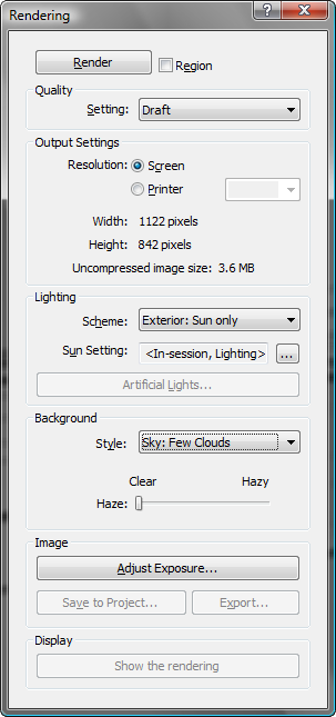

  1. Below the view, click (Show Rendering Dialog).
    Revit opens a Rendering dialog.
    Most of the rendering values do not need to be changed, since the actual rendering of the scene will take place in 3ds Max. The Scheme setting in the Lighting group is one possible exception.

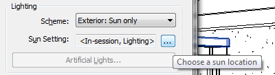

    If you choose Exterior: Sun Only from the Lighting group Scheme drop-down list, then in the 3ds Max scene only the Daylight system will be turned on and all the man-made light objects will be turned off. Conversely, if you choose Interior: Artificial Only, only the interior man-made light objects will be used in the scene and the Daylight system will be turned off.
  2. For this tutorial, we do not want to use the interior lights yet, so leave Scheme set to the default value, Exterior: Sun Only. (You will turn the man-made lights back on in 3ds Max, when you need them.)

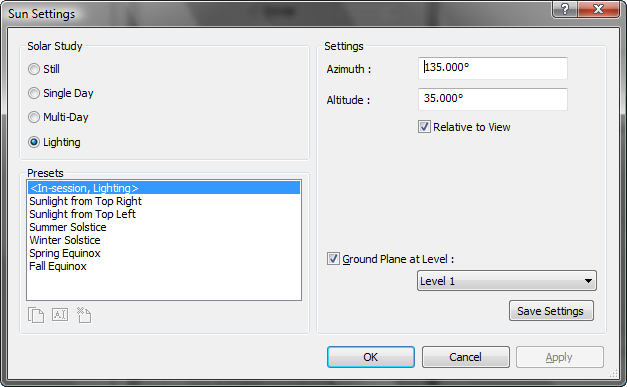

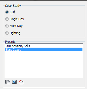

  3. For the Lighting group Sun Setting, click the sun location button.
    Revit opens a Sun Settings dialog, where you will set the geographic location and time of day for the position of the sun created by the daylight system.

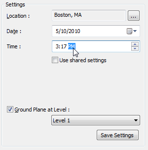

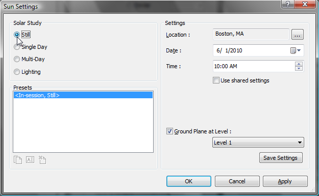

  4. In the Solar Study group, click to choose Still.
    (The Single Day and Multi-Day tabs let you choose presets that animate the position of the sun over the course of one or more days.)
    Keep the default location of Boston, Massachusetts, because we imagine the house to be on Cape Cod, which is only slightly south of the city.

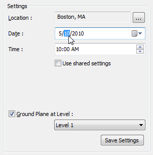

  5. In the Settings group Date field, change the month to 5 and the day of the month to 10.
  6. Change the time to 3:17 PM.
  7. In the Settings group, click Save Settings.

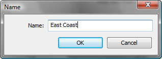

    Revit opens a Name dialog for the new preset.
  8. On the Name dialog, type East Coast, then click OK.
    This name is appropriate because you want the Daylight system to show the actual sun position at Cape Cod in mid-afternoon.
    The name of the preset now appears in the list in the Presets group.
