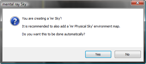

    3ds Max opens the “mental ray Sky” dialog, asking if you want to add an “mr Physical Sky” environment map for the background of your scene.
    Note: 3ds Max displays this dialog only if you are using the default set of tool options. If the dialog doesn’t appear, open the Environment And Effects dialog, and in the Environment panel Common Parameters rollout Background group, click the Environment Map button and assign the shader yourself.
    To revert to this default tools settings, from the Customize menu choose Custom UI And Defaults Switcher, and on the Choose Initial Settings dialog Initial Settings For Tools Options, choose DesignVIZ.mentalray.
  5. Click Yes.
    The sky map is cosmetic, and while it will create a nicely shaded background to the scene exterior, it will not affect the interior lighting levels in any way.

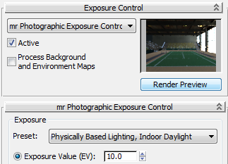

  2. From the Rendering menu, choose Exposure Control to open the Environment And Effects dialog.
  3. On the Exposure Control rollout, click Render Preview.
    The preview thumbnail takes a moment or two to render. The resulting image is quite dark because the default Exposure Value of 15 is not suitable for an indoor scene.
    Render preview with Exposure Value set to 15.

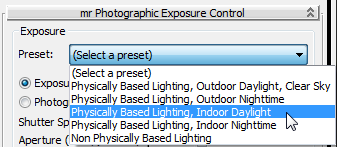

  4. From the “mr Photographic Exposure Control” rollout Exposure group Preset drop-down list, choose Physically Based Lighting, Indoor Daylight.
    The Exposure Value changes from 15 to 10 and the render preview thumbnail appears somewhat lighter.
  5. Change the Exposure Value (EV) from 10.0 to 9.0.
    The preview updates to show the effect of the new setting.

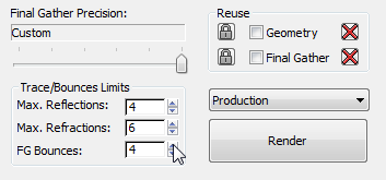

  6. On the main toolbar, click (Rendered Frame Window).
  7. On the Rendered Frame Window, in the Trace/Bounces Limits group (below the image area), set the number of FG Bounces to 4.
    This increases the number of times a ray of light bounces on object surfaces in a scene. Values of 4 through 7 are the most effective. Values under 4 produce less noticeable results, while values over 7 require a great deal of render time, with limited added benefit.
  8. On the Environment And Effects dialog Exposure Control rollout, click Render Preview again to see how the added bounces have brightened up the interior of the model.
  9. Click the Render button (or press F9) to render a full-size frame.

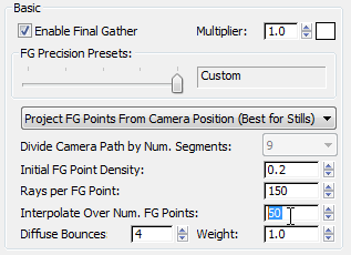

  1. On the Rendered Frame Window, click (Render Setup).
  2. In the Render Setup dialog Global Illumination tab Final Gathering (FG) rollout Basic group, set Initial FG Point Density to 0.2, Rays Per FG Point to 150, and Interpolate Over Num FG Points to 50.
    These values will eliminate most of the noise artifacts in the scene while ensuring a reasonably fast calculation time.
    To learn more about Final Gather and each of its settings, refer to the 3ds Max Help.
  3. On the Rendered Frame Window, make a clone of the rendered image, then render the scene again.
    This time, your image will take two to three times as long to render.
  4. Compare the two images to see how your edits to Final Gather have affected image quality.
    Some artifacts remain, but the overall image is much improved.
