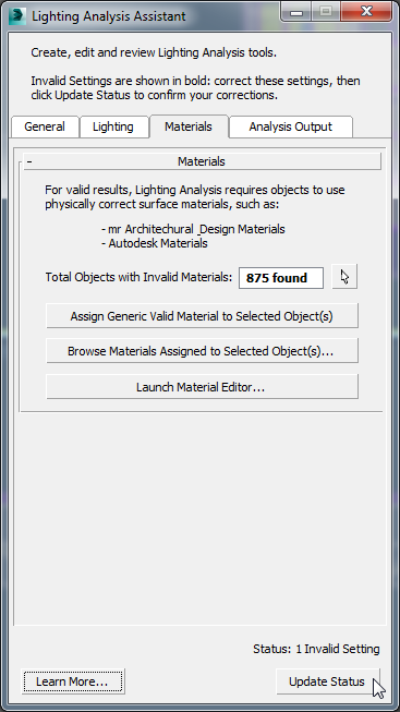

  2. Go to the Materials tab.

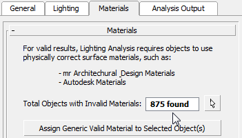

    The Lighting Analysis tool requires that all objects in the scene use physically correct surface materials. Only objects assigned the mental ray Arch & Design material or one of the Autodesk Materials (including materials from the Autodesk Material Library) are permitted. All other materials are considered invalid. Objects with no material assigned are also treated as invalid.
    The Materials rollout Total Objects With Invalid Materials box indicates the presence of 875 invalid objects in the scene, which you must now correct.

  1. Click the selection button next to Total Objects With Invalid Materials.
    This selects all objects in the scene that have an invalid material. As you can see in the viewports, most of the problem objects are the arena seats.

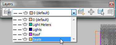

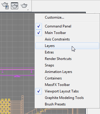

  2. Right-click an empty gray area of the main toolbar and choose Layers.
    3ds Max opens the Layers toolbar. A layer called Seats has already been created for you.
  3. Open the layer list and choose Seats from the list.
  4. On the Layers toolbar, click (Select Objects In Current Layer).
    All seat objects are selected. On the Modify panel, you can see that 874 objects are selected: This is just one object short of the 875 total number of objects with invalid materials.

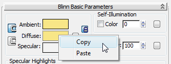

  4. On the Blinn Basic Parameters rollout, right-click the Diffuse color swatch and choose Copy.
    This saves the color for use in the new material you will now apply to the seats.

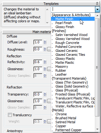

  8. On the Templates rollout, choose Matte Finish from the list.
    This gives the material a neutral reflectivity.

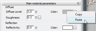

  9. In the Main Material Parameters rollout Diffuse group, right-click the Color swatch and choose Paste.
    This copies the color from the Standard material to the Arch & Design material.

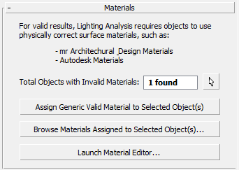

  1. On the Lighting Analysis Assistant dialog, click Update Status.
    On the Materials rollout, the Total Objects With Invalid Materials field updates to show only one remaining object with an invalid material.
  2. Click the selection button.
    3ds Max selects the Ground object, which is the ground on which the indoor arena stands.
    The Ground object has no material assigned to it. If you try to use (Pick Material from Object), nothing happens. To the Lighting Analysis Assistant, an object with no material assigned is not valid.

  6. On the Templates rollout, choose Matte Finish from the list.

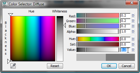

  7. In the Main Material Parameters rollout Diffuse group, click the Color swatch.
  8. On the Color Selector, change the HSV Value to 0.2.
    This gives the material low reflectivity.

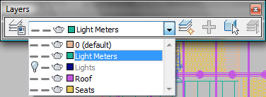

  1. From the Layers toolbar Layers list, choose Light Meters.
    Any Light Meter you now create will be added to this layer for easy selection later on.

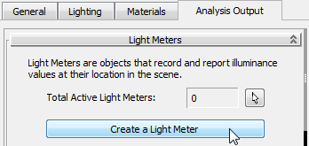

  4. On the Lighting Analysis Assistant dialog, go to the Analysis Output panel and on the Light Meters rollout, click Create A Light Meter.
  5. In the Top viewport, create the Light Meter by clicking the bottom left corner of the tennis court, then dragging diagonally until the Light Meter gizmo covers the entire surface of the court. Release the mouse.
