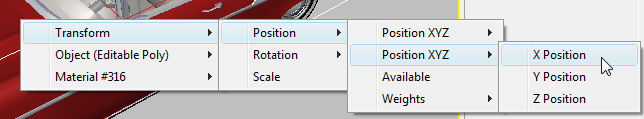

- Right-click the car body object and from the quad menu, choose Wire Parameters.
- From the pop-up menu, choose Transform
Position
(2nd) Position XYZ
X Position.

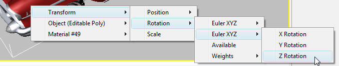

- Click the front left wheel of the car (Wheel-FL).
Rotation
(2nd) Euler XYZ
Z Rotation.

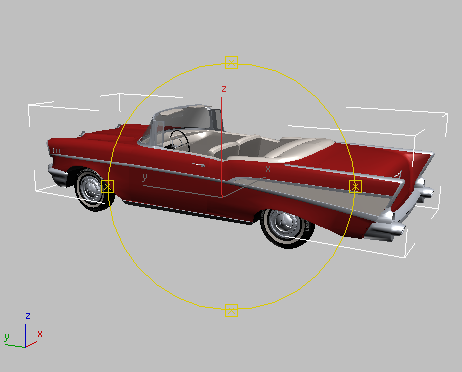

- In the Top viewport, select the Chassis object and rotate it –90 degrees (clockwise) so that its front bumper points at 12 o’clock.
The car is now oriented on the World Y axis, so you will begin working in this coordinate system.
Orbit the Perspective viewport until you can see the front left side of the car.
Move the car forward and backward on the Y axis. Notice that the wheels do not rotate. To get the wheels rotating, you will need additional animation controllers, ones that will control the car’s displacement in the Y direction. You will add these as sub-controllers, so you do not overwrite the controllers already in place.

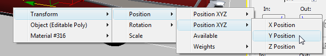

- Select the Chassis, then right-click and from the quad menu, choose Wire Parameters.
- From the menu, choose Transform
Position
(2nd) Position XYZ
Y Position.

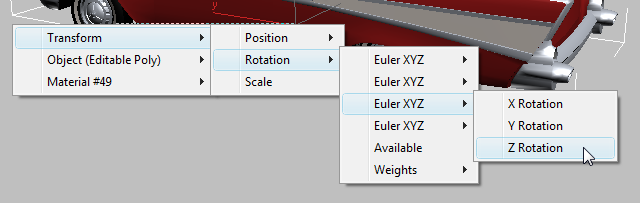

- Click the front left wheel (Wheel-FL).
Rotation
(3rd) Euler XYZ
Z Rotation.

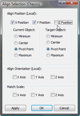

- In the Top viewport, click a point near the car to place a Point helper.
- With the Point helper still selected, on the main toolbar click
(Align), then in any viewport, click the Chassis object.
- In the Align Selection dialog
Align Position group, make sure X Position and Y Position are on and Z position is off.
- In the Current Object and Target Object groups, make sure Pivot Point is chosen, then click OK.

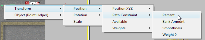

- Select and right-click the Point helper, then from the menu choose Wire Parameters.
Position
Path Constraint
Percent.

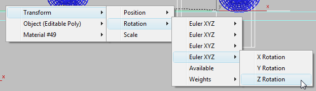

- Click one of the car wheels and choose Transform
Rotation
(4th) Euler Rotation
Z Rotation.
