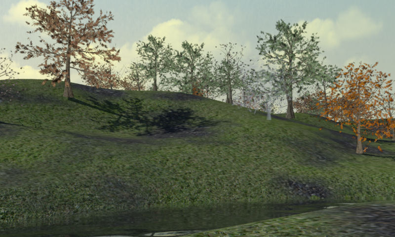

    Rendered 50-tree view of the particle forest
    The 50 particle trees should take just a minute or two to render. If, on the other hand, the scene were made up of 3D trees at 30,000 polygons each, 3ds Max would need to process over a million polygons: This would require a great deal more time to render.
    There is one aspect to watch out for when using particle systems to create trees with shadows. As the next illustration demonstrates, the base of the tree on the left does not quite match the base of its shadow.
    Tree trunk not aligned with particle tree shadow
    Recall that you created two sets of particle trees: One set oriented to face the camera and another, hidden set that faces the sun. Depending on the respective positions of the light source and the camera, a hidden tree might cast a shadow that is out of alignment with the visible tree.
    To solve this problem, you can rearrange tree placement by changing the particle trees’ Seed value, or you can add objects such as rocks to obscure unwanted detail.
