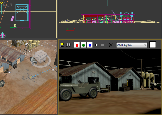

To display an ActiveShade window in a viewport:
- Click or right-click the Point-Of-View (POV) viewport label. From the POV viewport label menu, choose ActiveShade.
Note:
You can't make a maximized viewport an ActiveShade window, or maximize an ActiveShade window.
To change an ActiveShade viewport to another kind of viewport:
- Turn on the toolbar in the ActiveShade viewport.
- Right-click the toolbar.
- In the pop-up menu, choose the type of view to display.
You can also restore the viewport to its previous status by right-clicking the viewport and choosing View (upper-left) quad
Close.

To display the toolbar for the ActiveShade viewport:
- Press spacebar.
spacebar toggles the toolbar display. In viewports, the toolbar is off by default.
(This is a main user interface shortcut, so the Keyboard Shortcut Override Toggle can be either on or off.)
ActiveShade viewport with the toolbar displayed
