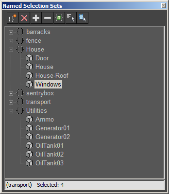

Named Selection Sets Dialog
The Named Selection Sets dialog, available from the Edit menu and the toolbar, is a modeless dialog that lets you create named selection sets or select objects to add to (or remove from) a selection set, directly from the viewport. The dialog also lets you organize your current named selection sets, browse their members, delete or create new sets, or identify which named selection sets a particular object belongs to.

Interface
In the Named Selection Sets dialog, all of the current named selection sets are displayed. By clicking the plus (+) or minus (-) icon, you can expand or collapse (respectively) the object list for each set.
The buttons along the top of the dialog let you create or delete sets, add or remove objects from a set, select objects (independently or as a selection set), and see which named selection set(s) a particular object belongs to.

Status Bar
Displays the current named selection set, as well as what’s currently selected in the scene. If more than one object is selected, the number of selected objects is displayed.
