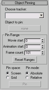

Interface
- Choose Tracker
- Shows all the current trackers as set up in the Motion Trackers rollout. Use this to select the tracker whose feature movements you will use to control the pinned 3ds Max object. The feature must have been tracked already over the frames you want to use, with the Track and/or Movie Stepper rollouts. Note that the accuracy of the pinning is determined by the accuracy of the match, so subpixel tracking is highly recommended.
- Object To Pin
- Lets you choose the object in 3ds Max scene for pinning and animating. By default the tracking object associated with the selected tracker is preloaded into this button. You can use this picker if you wish to pin a different object.
Pin Range group
- Movie Start
- The movie frame from which to start using tracked feature positions.
- Animation Start
- The frame in the 3ds Max animation at which to start keyframing the move of the pinned object.
- Frame Count
- The number of frames to animate. There must be enough tracked positions in the selected tracker to cover this number of frames.
- Reset Ranges
- Reloads the maximum frame number and count ranges into the above spinners from the current movie and 3ds Max scene settings.
- Pin Space
- Lets you select the plane of motion in which the keyframed pinning will occur.
- Screen Moves and animates the pinned object in the plane of the screen at its current depth in the scene. This is equivalent to dragging an object around in the Screen reference coordinate system in 3ds Max.
- Grid Moves and animates the pinned object in the plane of the active grid. This lets you set up an arbitrary plane of motion for the pinning by constructing a grid helper object in the desired place and making it the active grid. If you don't have a grid helper set up and active, the pinning will occur on the 3ds Max Home Grid.
- Pin Mode
- Lets you choose between two different pinning modes: absolute and relative.
- Absolute Places and moves the pinned object exactly over the tracked feature. If combined with grid space, the object is also placed and moved directly on the active grid plane.
- Relative Leaves the pinned object at its current position in space and moves it so that its projected position relative to the tracked feature remains the same throughout the pinning frame range. This makes it possible to animate an object that you don’t want placed exactly over a feature, or to animate an object using several features in successive frame ranges. (For example, a computer generated jaw can track an ear for some frames, then a nose for others in a talking animal shot). If combined with grid space, the object is not moved onto the grid plane, but keeps its height above the grid and is moved parallel to it.
- Pin
- Performs the actual pinning, moves the object to follow the selected feature and places a keyframe at each frame in the pin frame range. As with the other keyframing operations in the tracker, you can undo a pin using the 3ds Max Undo function. You might also find it useful to perform keyframe reduction afterwards in Track View.
