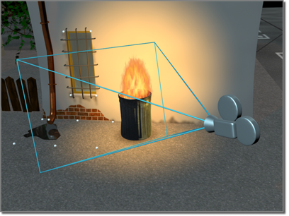

Real-world camera films a scene (the white dots will be tracking points).

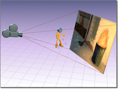

Resulting footage to be tracked and used as a background.

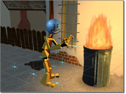

After camera tracking, scene geometry (the character) matches the filmed background.
