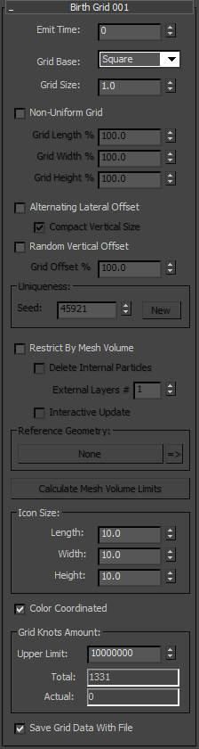

Interface
Birth Grid positions the particles it creates within a 3D, box-shaped grid. By default, the particles are evenly spaced; the overall spacing is determined by the Grid Size setting. The higher this value, the greater the spacing between particles, and vice-versa. To produce uneven spacing, turn on Non-Uniform Grid and use its three numeric settings to adjust spacing on individual axes as percentages of the overall spacing. Both Grid Size and, optionally, the Grid Length/Width/Height % settings specify particle density within the grid.
Conversely, the volume of the 3D grid is determined by the Icon Size settings (Length/Width/Height); these do not affect density. To achieve a grid shape other than a box, use
Restrict By Mesh Volume with a mesh object. You can thus create a grid of any shape, filled or hollow (you can specify the shell thickness with the External Layers setting). By nesting objects in the Mesh Volume object, you can specify arbitrary layers of particles within the volume.

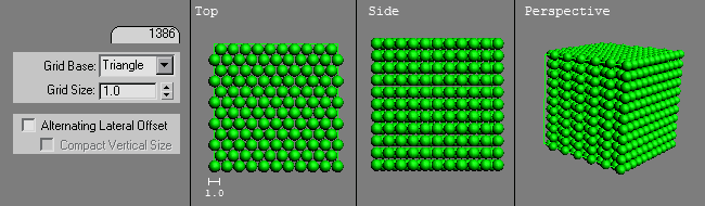

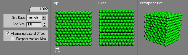

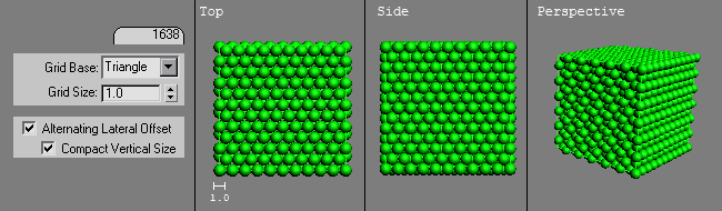

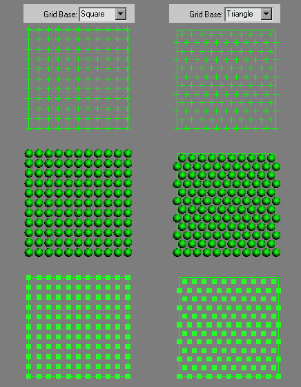

- Grid Base
- Choose how to pack the particles on a single grid layer: in a square or triangular layout. The two choices are depicted as viewed from the top in the following illustrations:
Square Triangle

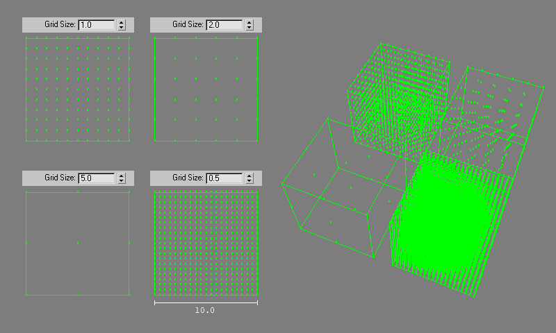

- Grid Size
- The distance between grid knots; each particle is born at a knot. When you use this parameter with Non-Uniform Grid off (see following), all knots are equidistant from one another.
Comparison of different Grid Size values

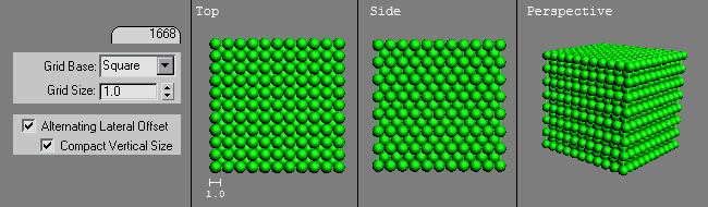

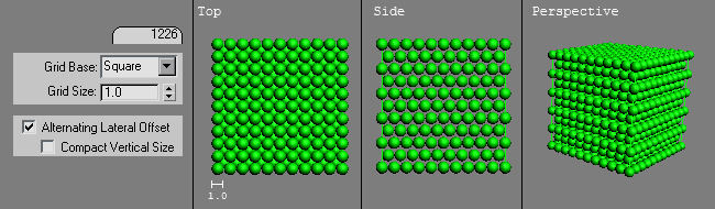

- Alternating Lateral Offset
- Places particles in more compact manner, similar to the way fruit is stacked at a produce stand. When on, makes Compact Vertical Size available.
- Compact Vertical Size
- Controls whether the vertical grid size is adjusted in order to make particles to stay more compact where grid size is not the distance between the layers but the distance between the particles of the layers.
For examples of using Alternating Lateral Offset and Compact Vertical Size with the different Grid Base options, see the following illustrations.

- Icon Size
- Set the size of the helper icon in world units. This affects the volume of the icon but not the density of particles. Keep in mind that, even when using the Restrict By Mesh Volume option, Birth Grid creates particles only inside the icon volume.
For the most predictable results when using the density settings (Grid Size and Non-Uniform Grid), do not scale the icon directly; instead, use the Icon Size settings.
- Color Coordinated
- When on, the Birth Grid icon uses the same color as the Display operator in the event.
Grid Knots Amount group
- Upper Limit
- Use to specify the maximum number of grid knots for Birth Grid to use.
- Total
- The number of grid knots in the operator's icon, without taking into consideration the restrictions imposed by a reference geometry mesh.
- Actual
- When using Restrict By Mesh Volume with a reference geometry mesh, shows the number of particles after the mesh-volume restriction.
