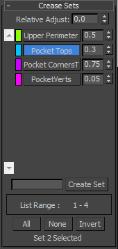

Crease Sets rollout
Whenever you have selected vertices or edges, you can save them as a crease set. This rollout provides controls for managing crease sets and adjusting their values.
- Relative Adjust
- Adds the amount you specify with the numeric field to all selected crease sets. Adjustment can be positive or negative.
- [Crease Set List]
- Lists all crease sets, with a scroll bar to the left.
When you create a crease set, its name appears on a button in this list. Each entry in the list also includes the set's color swatch and Crease value.
To toggle a set's selected status, click its name. When a set is selected, its button background color is blue. You can delete all selected sets by right-clicking the list and choosing Delete Selected Sets.
When Crease Set Display is on (see Options rollout, following), the sub-objects in each crease set display in the viewports in the set's color, with the color saturation indicating the Crease value. To change a set's color, click its color swatch in the list.
Right-clicking an item in the list opens a menu with commands related to that set or all sets. For details, see the Crease Sets List Right-Click Menu section, following.
- Create Set
- Creates a set from the current sub-object selection and adds it to the list. If the text field on the left side is empty, uses a default name; otherwise, uses the name specified in the text field, with an appended number.
- List Range
- Shows the range of visible crease sets. To see other sets, if necessary, scroll the list.
- All/None/Invert
- Selects, deselects all sets, or inverts the selection.
- Sets Selected
- Shows the number of selected crease sets.

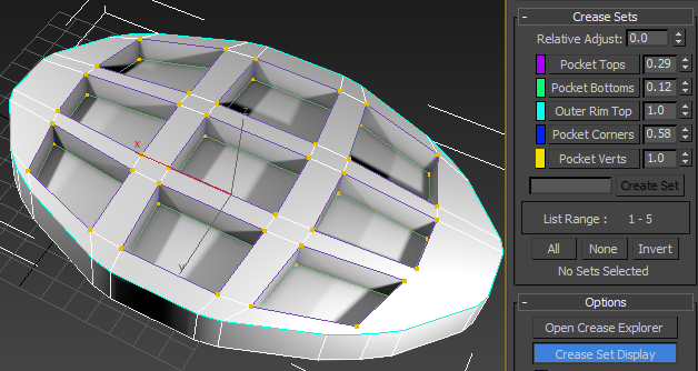

- Crease Set Display
- When on, displays each set's elements using its assigned color. The displayed color saturation indicates the set's Crease value.
Each crease set appears in the viewport in its assigned color.
