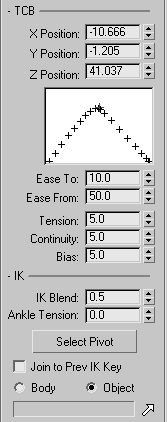

Example: To set TCB/IK Values when pasting postures:
- Create a biped and then
create a new collection. Name it Hands.
- Select the
biped's right hand, and on the Key Info rollout,
set a key.
- In the TCB group, set Ease To to 10, Ease From to 50, and all three TCB values to 5.
- In the IK group, set IK Blend to 0.5. Choose the Object [Object Space[ option. Then
set another key.

Note: If part of the pasted biped is linked to an IK object, that object is maintained even while the new pose or posture is honored. In other words, if an incoming pose requires a change in an existing link between a biped limb and an IK object, the link is maintained and adjusted accordingly.
- Default Sets (on the Key Info rollout) the TCB Ease To and Ease From to 0, and Tension, Continuity and Bias to 25. These settings are unrelated to what was copied or where it is pasted. Any IK key values already set are maintained. Otherwise, values will be obtained from the position in time between the previous and next keys.
- Copied Sets the TCB/IK values to match those from the copied data. If a copied pose or posture is not on a key, the TCB/IK values are based on interpolation from the previous and next keys.
- Interpolated Sets the TCB values to an interpolation from the animation on which you are pasting. If an existing key is being pasted, its TCB values are maintained. Along the same lines, existing IK values are also maintained when pasted. If no key is present, the IK values are set from the position in time between the previous and next keys.
