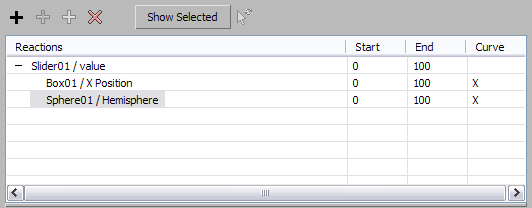

In the Reactions list, the master entry Slider01 / value appears.
In the Reactions list, the slave entry Box01 / X Position appears under the master entry. Also, a new state appears in the States list for the newly added slave track. This simply says that, when the slider value is 0, the box's X position should be what it is currently. However, a reaction needs at least two states to be meaningful. You'll learn how to accomplish this shortly.

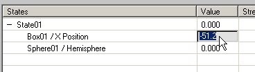

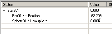

Currently, the box is where you created it, but you might want it to start out at a different location. However, because the box is a slave of the slider, you can't move it freely on the X axis. You'll use the Reaction Manager to set the X position of the box to a specific value.
You might find it difficult to set an exact value by dragging, which changes only the tenths (and higher) value. You can use the keyboard to specify a more exact value.
The value highlights and becomes a keyboard-editable field.
The value now displays as –50.000.
You can use the same mouse and keyboard methods to change state (master) values as well.

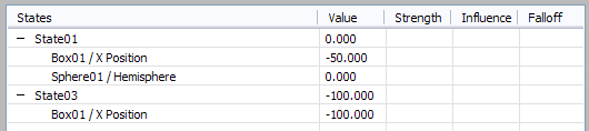

First, you'll set a new state to move the box leftward for negative slider values.
You can't do it, because it's slaved to the slider value.
When Create Mode is on, you can change master and slave properties and use the current properties to create new states.
Highlighting the slave entry lets you manipulate the slaved value interactively in the viewport while Create Mode is on. Then, when you click Create State, a new state is created for that slave only. If you highlight the master instead, you can manipulate all slaves freely, but then clicking Create State creates a new state for all slaves. Reaction Manager is a complex tool, so in general it's best to keep the data as simple as possible.
The Reaction Manager adds a new state, State02, with the state (slider) value at –100.0, and the box at its new X position.

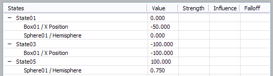

Next, you'll set a new state so the right half of the slider range affects the sphere's Hemisphere value.
The Hemisphere parameter is unavailable, because it's slaved to the slider value.
The Hemisphere parameter is now available.
The Reaction Manager adds a new state with the state (slider) value at 100.0, and the Sphere01 / Hemisphere value at 0.750.

The Reactions list displays a hierarchical view of the master-slave relationships of objects with Reaction controllers in the scene. You can use its controls to add and delete masters and slaves, change start and end frames, and toggle usage of the graph curve. These controls are available both on the toolbar above the list and in the list itself.
