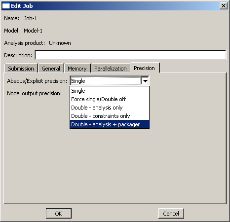

An analysis using Abaqus/Explicit is executed in the same manner as an analysis using Abaqus/Standard. Refer to the Installation and Operations Guide for more information on executing Helius PFA with Abaqus. The only difference to note is that Abaqus/Explicit allows you to select the amount of precision to use for numerical calculations (single or double precision). Helius PFA currently only supports double precision. The default method is single precision, therefore you must specify the double precision option. If the job is submitted from the command line you can use the 'double=both' or '-double both' option to specify a double precision analysis. For example:
abaqus job=explicit_job double=both
If the analysis is submitted from within Abaqus/CAE double precision can be selected under the "Precision" tab in the "Edit Job" dialog box. Choose the "Double - analysis + packager" option under the Abaqus/Explicit precision drop-down menu as shown below. This option can also be permanently set via the Abaqus environment file (abaqus_v6.env) by setting the double_precision variable to a value of BOTH.

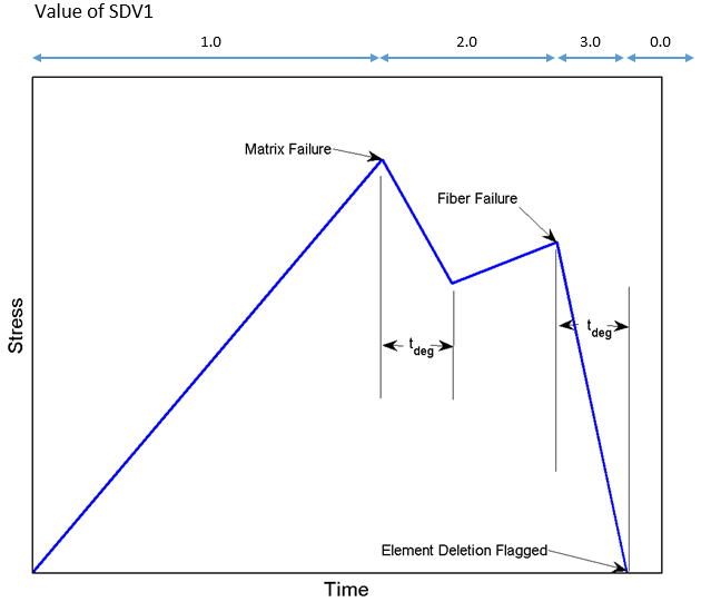

If desired, integration points can be deleted after ultimate failure of the composite material. Once all of the integration points in an element have been flagged for deletion the element will be permanently removed from the analysis. To turn on element deletion for a material set the DELETE parameter on the *DEPVAR keyword to a value of 1. For example:
*MATERIAL, NAME=IM7_8552 *USER MATERIAL, CONSTANTS=3 1, 1, 1 *DEPVAR, DELETE=1 12
An integration point is flagged for deletion anytime a fiber failure completes. Completion means that fiber failure initiates and the material has completely degraded linearly to its fiber failure state over the material time degradation period (see the image in Appendix A10). For woven composites a fiber failure in either tow will trigger element deletion regardless of the failure state of the other tow.
The value of SDV1, the damage variable, behaves differently in Abaqus/Explicit analyses. Following a fiber failure event, the stiffness of the integration point is reduced to zero over some degradation time which is specified in UMC #11. After the degradation is complete, the value of SDV1 changes from 3.0 to 0.0.
| Value of SDV1 | Discrete Composite Damage State | |
| 1.0 | Undamaged Matrix, Undamaged Fiber | |
| 2.0 | Failed Matrix, Undamaged Fiber | |
| 3.0 | Failed Matrix, Failed Fiber | |
| 0.0 | Element stiffness reduced to zero after fiber failure and degradation time |
