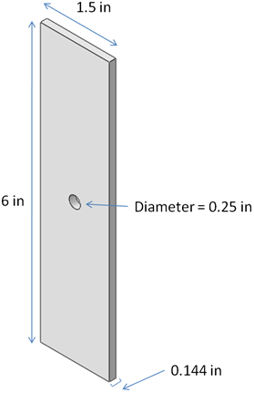

The model is based on coupon level test results from the National Institute for Aviation Research (NIAR). Specifically, an open-hole tension (OHT) plate made from T700/2510 is built and compared to the experimental results [1] determined by NIAR. The plate layup is [45/0/-45/90]3S and the plate dimensions are given below.
