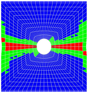

  4. To plot SVAR1 using a PLESOL contour plot, enter PLESOL, SVAR, 1 into the command prompt. The default plot will show the bottom section point of the bottom layer and the top section point of the top layer.
  5. Since there are 3 possible values of SVAR1 for unidirectional Helius PFA materials, it is useful to adjust the contour color values. Click PlotCtrls > Style > Contours > Non-uniform Contours. In the dialog box that appears, set V1 = 1, V2 = 2, and V3 = 3 and click OK. The contour plot should be similar to the plot shown below. Minor differences are usually the result of mesh variations.
  6. The following table lists the three possible values for SVAR1 and the corresponding failure states and contour colors.

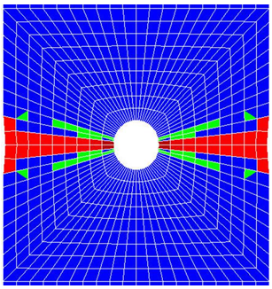

    To view results in a specific ply (or layer) of the composite plate, use the LAYER command.
  7. Enter LAYER, 2 in the command prompt to view results in ply 2 (a 0° ply).
    Note: It may be necessary to click Plot > Replot to refresh the Graphics Window. The contour plot of SDV1 for ply 2 at the end of the load step is shown below.

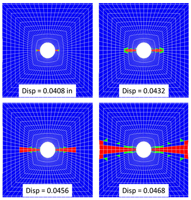

  8. Viewing the progression of failure is often useful for visualizing the way a structure fails. Click Main Menu > General Postproc > Read Results or use the SET command to view results at specific points in time.
  9. Starting at Substep 1, progress through the step while refreshing the Graphics Window to determine when failure initiates and how failure propagates in ply 2.
    • Enter the command, SET, 1, substep# or use Main Menu > General Postproc > Read Results > By Load Step.
  10. The progression of failure in ply-2 is shown below. As expected, failure initiates at the corners of the notch and progresses laterally towards the edge of the plate until ultimate failure.
