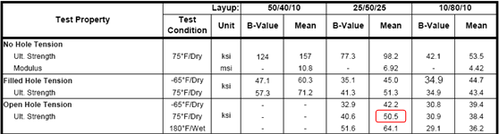

The load-displacement plot is shown below. The sharp drop in stiffness at a displacement of 0.0468 corresponds to ultimate failure of the plate. The simulated ultimate load is 10,180 lbs and the strength is 47.1 ksi. The experimental [1] strength of the plate is given in the table below as 50.5 ksi. The ultimate strength predicted by Helius PFA and the experimental strength differ by 6.7%.
