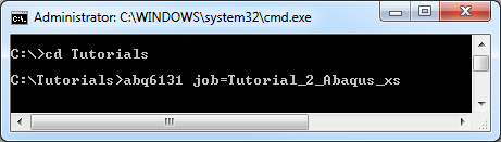

  1. Open a command prompt.
  2. Change the directory to the directory where the input file is located:
    >>cd <directory containing input file>
  3. Submit the job as shown below (in this case with Abaqus 6.13-1):
    >>abq6131 job=Tutorial_2_Abaqus_xs
