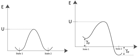

For the purposes of fracture and fatigue, one equilibrium state is the unbroken state and the other is the broken state. The process is illustrated schematically in the left image below. Thus, a similar equation can be written for bond healing as

 so that the reduction in the activation energy is simply the product of activation volume and the stress. The image below on the right shows how the stress modifies the activation energy. Modifying Equation (38) to reflect the effect of an applied stress gives
