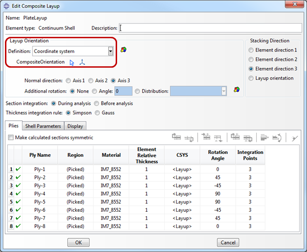

  4. In the Edit Composite Layup dialog box that appears, choose Coordinate system from the Definition drop-down list.
  5. A datum coordinate system needs to be created to orient the plies. In the Layup Orientation box, click the Create button that lies inside the red box highlighted in the image below.

  9. In the dialog box that reappears, select the plate from the viewport as the Region, IM7_8552 as the Material, and 1 as the Element Relative Thickness.
    • Tip: to edit all plies at once, right-click on the Region, Material, and Element Relative Thickness buttons and select the Edit option (the option at the top of the menu).
  10. Enter the Rotation Angle for Ply-1 thru Ply-8 as 0, 45, -45, 90, 90, -45, 45, 0, respectively. The dialog box should appear as shown in below.

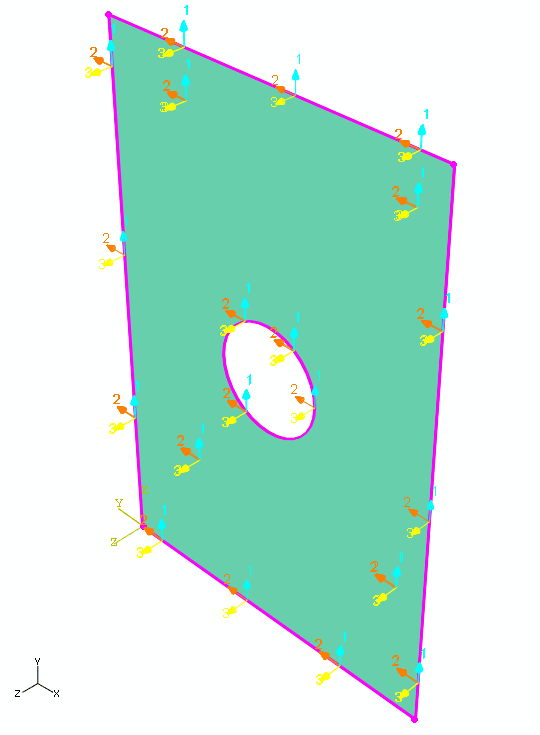

  11. Click on the Rotation Angle entry for Ply-1. The orientation of Ply-1 is now shown relative to the plate in the viewport. Check to make sure that Ply-1 has the orientation shown in below.
    The 1-axis in the figure below represents the fiber direction since 1 was specified as the fiber direction in the Create Composite Material plug-in (Create a User Material with Helius PFA). If "2" was specified as the fiber direction, the 2-axis would represent the fiber direction.
