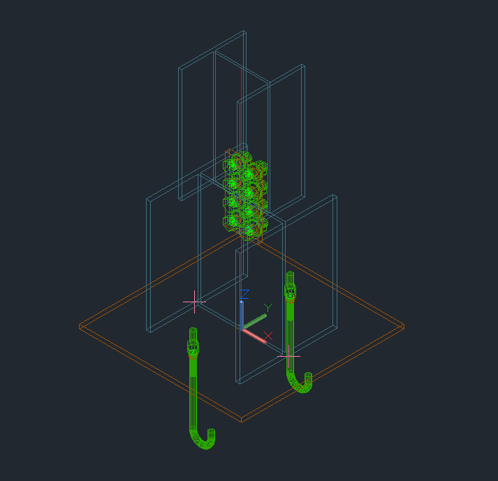

Prior to running this command in Advance Steel, you will need to add the necessary Informational Attribute directives in the AssemblyInfo.cs file as shown in the Hello World Walkthrough. You will also need to add an entry to the Registry for the addin unless the command was added to an existing Advance Steel addin dll.
After running the CreateConnectors command in Advance Steel and zooming in, you should see something like this:
