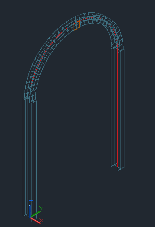

The Plate class represents a plate in Advance Steel. There are several overloads for the Plate constructor to create rectangular or circular plates in the document. The following code will add a square plate (100mm) at the center point and on the face of the curved beam created above.
Code Region: Adding a square plate
//create a plate on the curved beam
Point3d plateOrig = arcPoint;
plateOrig.x = 100;  // 1/2 of curved beam width
Plane platePlane = new Plane(plateOrig, Vector3d.kXAxis);
Plate myPlate = new Plate(100, 100, platePlane, plateOrig);
myPlate.WriteToDb();
Running the command

Prior to running this command in Advance Steel, you will need to add the necessary Informational Attribute directives in the AssemblyInfo.cs file as shown in the Hello World Walkthrough. You will also need to add an entry to the Registry for the addin unless the command was added to an existing Advance Steel addin dll.
After running the CreateElements command in Advance Steel and zooming in, you should see something like this:
