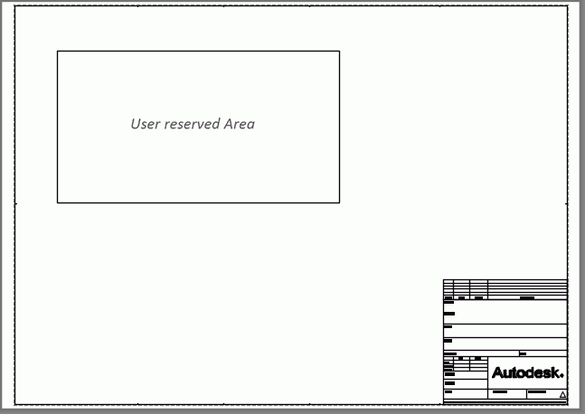

  2. Create the shape of the reserved area from various AutoCAD® options like closed polylines, rectangles, circles etc. In the following example a rectangle is used:

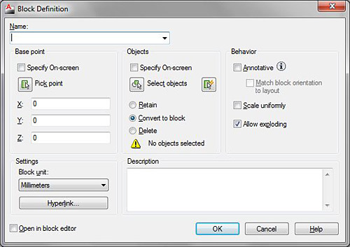

  3. After the area is defined transform it into an AutoCAD® block with a specific name, recognizable by Advance Steel as a reserved area using the BLOCK command.
  4. In the dialog box, fill in the following information:
    • Name: ADVANCESTEEL_RESERVED_AREA
    • Base point: one of the area corners
    • Objects: select the reserved area object (in this example: the rectangle object).
  5. Click OK.
    The block is created.

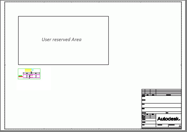

When this prototype is used to create a drawing, the area in the rectangle will not be used for drawing arrangement, and the first detail view will be created on the left side / first column, under the rectangle:
Note: The rectangle defining the user reserved area can be moved on the prototype file to a hidden layer, to avoid it appearing on the created drawings. Moving it on hidden layer will not affect its functionality.
