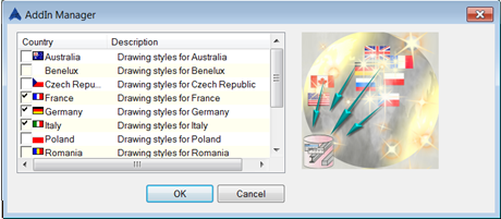

When you install, for example, the English Europe Advance Steel version, you get the corresponding Drawing Styles. To install Drawing Styles from other countries, you need to modify your installation and then load the drawing styles.
To modify the installation
  1. Go to Start > Control panel > Programs and Features.
  2. Select Autodesk Advance Steel 2016 and click Uninstall/Change.
  3. Click Add or Remove Features.
  4. Select the countries of the Drawing styles you want to install.
  5. Click Update to start the installation.
  6. Click Finish and close the control panel dialog box.

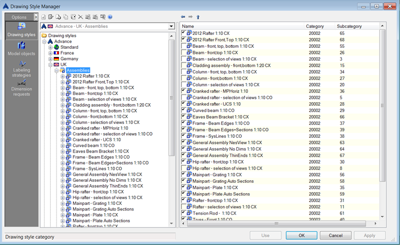

To load drawing styles in Advance Steel
  1. Start Advance Steel.
  2. On the ribbon, click (Country settings).
    • Tools Tools (Country settings)
  3. Select the country of the Drawing styles you wish to access and click OK.
When you open the Drawing Style Manager you can see in the Advance branch Drawing Styles for the selected countries.
You can select them from here, and click Use to start the drawing creation.
