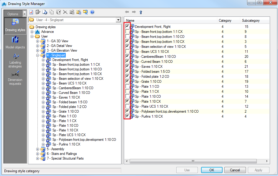

Customize the set of available drawing styles
Output
tab,
Document Manager
panel: click
In the
Drawing Style Manager
window select the category from which to add a drawing style.

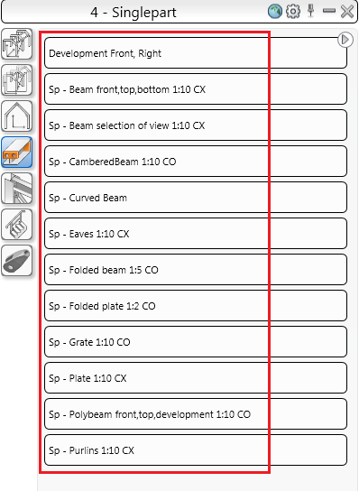

From the right side of the window enable the check box in front of the drawing styles you want to display in the
Drawing Styles palette
Click OK.
Open the Drawing Styles palette to see the result.
