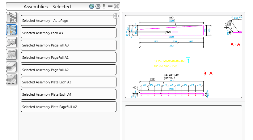

  1. Drawing Styles palette

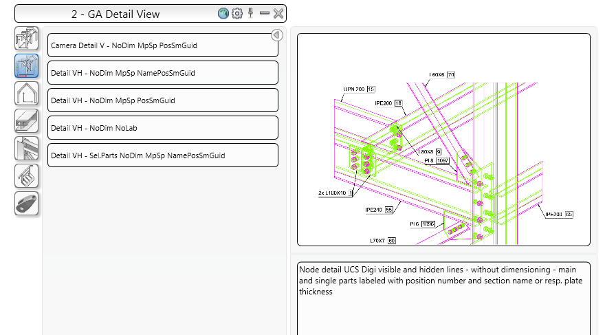

  2. Drawing Processes palette

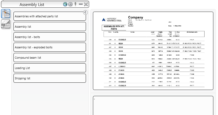

  3. BOM Templates palette
The palettes allow you to quickly browse and use drawing styles and drawing processes for drawing creations as well as list templates for BOM list creations. The categories are represented by intuitive images.

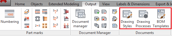

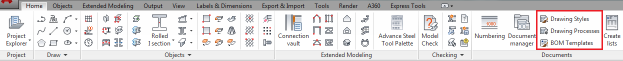

The Quick Documents Palettes can be opened using the buttons located either:
Palette Quick Documents Palette name
