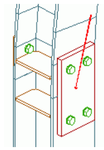

. The selected objects are highlighted in red.
Selected objects can be unmarked. Thus markings can be removed from a selection group of marked objects.
The selected objects can be deselected using the icon Remove selected objects from marking. Markings can be deleted from a current group of highlighted objects.

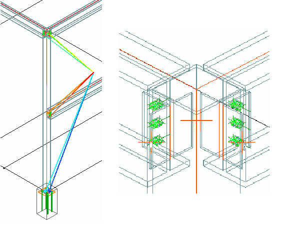

. Within a large model, highlighted objects are not always easy to find. For example, clashes are usually small, therefore it is often very hard to find the collision solids in the model without help.
The objects can be displayed with an arrow starting from the center of the viewport for easy identification. The arrow can be deleted or hidden, just like any other object.
) you can zoom directly to an area in the arrowhead.

Using the Search marked objects tool, the objects can be displayed with an arrow starting from the center of the viewport for easy identification. After finding the highlighted objects, this tool allows viewing the area in the arrowhead.
