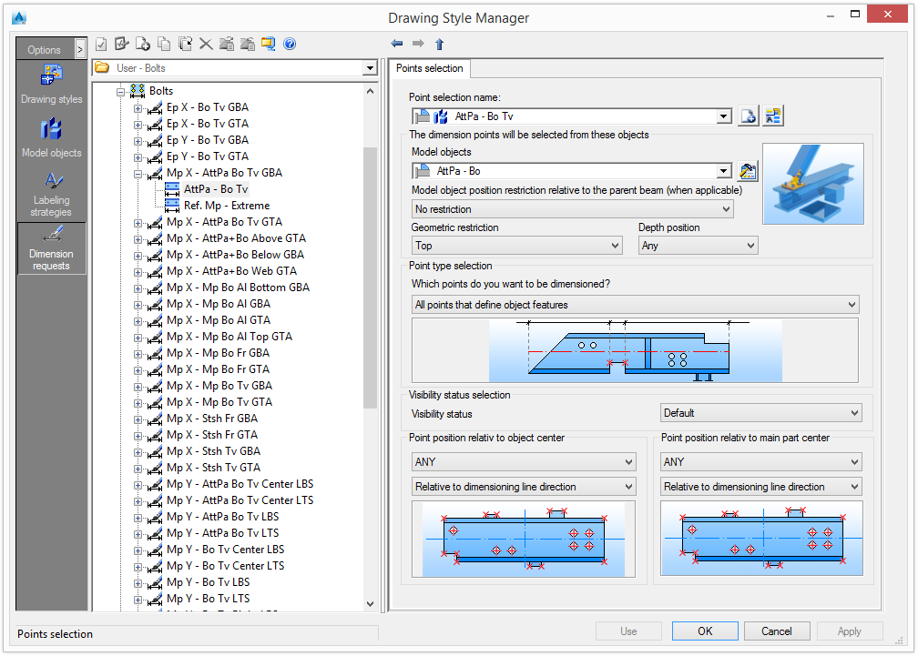

A dimension point selection rule contains settings for model objects and geometric restriction, point type, position on object or on main part.
The Points selection rules can be shared by different dimension strategies. Consequently, modifications affect all the dimension strategies that use the modified points selection rule.
Select a predefined point selection rule from the list. The existing rules can be renamed and new rules can be added.
Button Function
Define a new point selection rule. A copy of the current settings is created and a new item appears in the drop-down list.
Rename a point selection rule. The current settings are saved under a different name.
Select the model objects to be dimensioned
Select model objects and the geometric restrictions for defining the objects used in the selection of dimension points. Click Set to configure the model objects. For more information, refer to Model Objects.
Define the points to be dimensioned

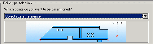

Select the properties of the objects geometry used in the points selection process (e.g. objects contour, object features, holes etc) in the "Point type selection" area. Furthermore, points can be used as reference.

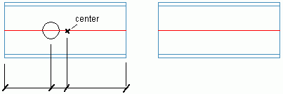

It is possible to distinguish between three categories of point types:

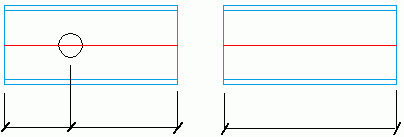

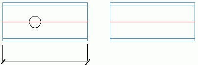

  1. As reference -This option provides dimension points only when there are other dimension points; otherwise, those points will not be used. This point selection type is useful when no dimensions are necessary.
    Example:
    A dimension line if there is a hole, and if there is no hole in the main part, no dimension chain is created.
    Points selection rule Result
    Holes - All features
    Main Part - Extreme as reference

Visibility status selection
Visible and hidden dimension points for each dimension definition and dimensioned element are selected using the Visibility status.

Point position on object
Set geometrical restriction of the selected points in the "Point position on object" area. Two options are available:
  • Point position on object - used to filter the points depending on their position on the attached parts
  • Point position on main part - used to filter the points depending on their position on the main part.

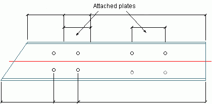

Examples: Point position on object and on main part

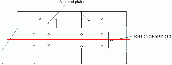

The following example illustrates the behavior of setting Point position on the object and on the main part for a beam with holes and two attached plates in the front view of a beam.
  • The behavior of the setting Point position on object:
    Use the Left restriction relative to the object for the attached plates and the holes.
    Both attached plates and all groups of holes from the main part are dimensioned as shown in Figure 69.
  • The behavior of the setting Point position on main part:
Only the attached plate and the holes placed in the left side of the main part are dimensioned as shown in Figure 71.
