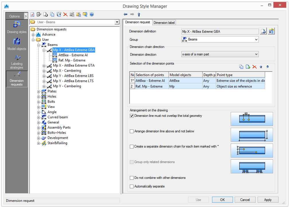

Dimension Definition Properties
Set different options for the Dimension direction, Selection of dimension points or Dimension chain positron accessing the Dimension Definition Properties.
A dimension definition contains the following settings:
The existing dimension definitions can be renamed and new definitions can be added.
Button Function
Define a new dimension definition. A copy of the current settings is created that can be moved to another group using the Group drop-down list. A new item appears in the tree panel under the specified group.
Rename a dimension definition. The current settings are saved under a different name.
