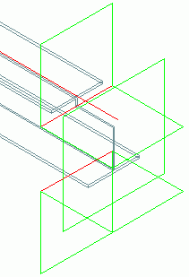

You can create parametric copes on beams. The size is defined based on a beam (floor beam) where the beam is adjusted.
The feature is based on rules, so the properties can be modified through the connection object.
The processing objects are created either as the processing object Cope or as the processing object Contour processing.
The clearances between the beams can be set with the parameters.
Examples
- Parametric copes created using Copes as processing objects
- Parametric cope created using Contours as processing objects
