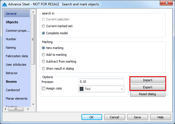

Starting with this update release, you have the option to export and import Search filter configurations from a model or from a BOM on drawing template.The export file, also called Query is an XML file that contains the configuration made in the Search and Mark objects window.

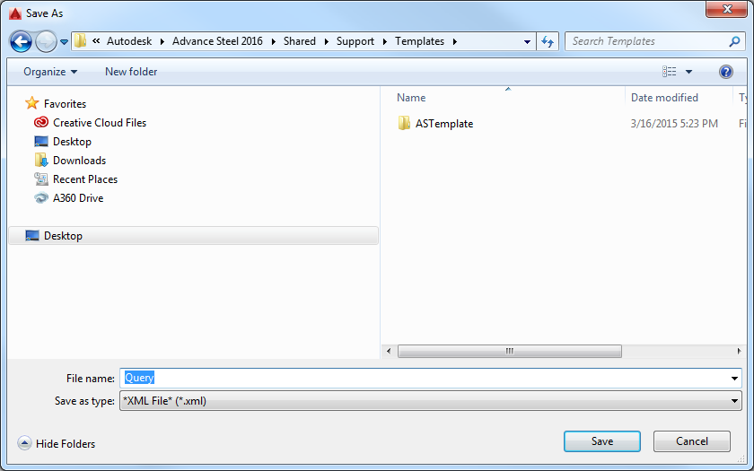

After setting the desired search criteria, you can now use the Export button, located in the General tab, to save your query. A Save As window opens, prompting you for the location where you want to save the query:

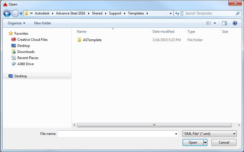

The import procedure is similar to the export one. An Open window appears, prompting you to select the location of the query:
