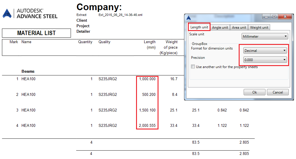

Correctly applied precision results for external BOM lists, according to the Template Units settings
This is most visible when the trailing zeros in the results are removed using the Management Tools Suppress the last zeros (used for BOM) default.
