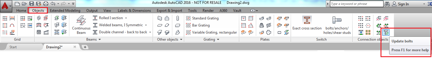

For models that were saved in Advance Steel 2016, it is highly advisable to use the "Update bolts" command when first opening the model in Advance Steel 2016 with Update Release 2:
This command will update the lengths of all bolts in the model, whether they are created by automatic connections or independently.
