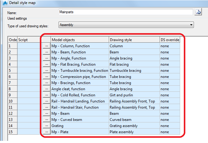

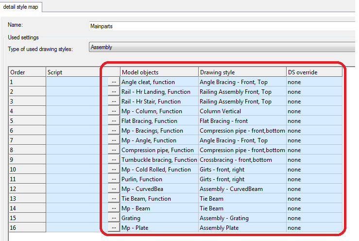

Reordered the process settings (detail style map) to better select the drawing style for assemblies and assemblies with attached parts processes:
| Before | Now |

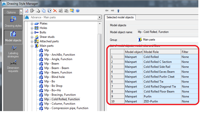

Included additional model role in the Mp - Cold Rolled model object:

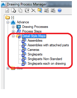

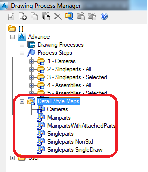

Renamed the Detail style maps process:
| Before | Now |
