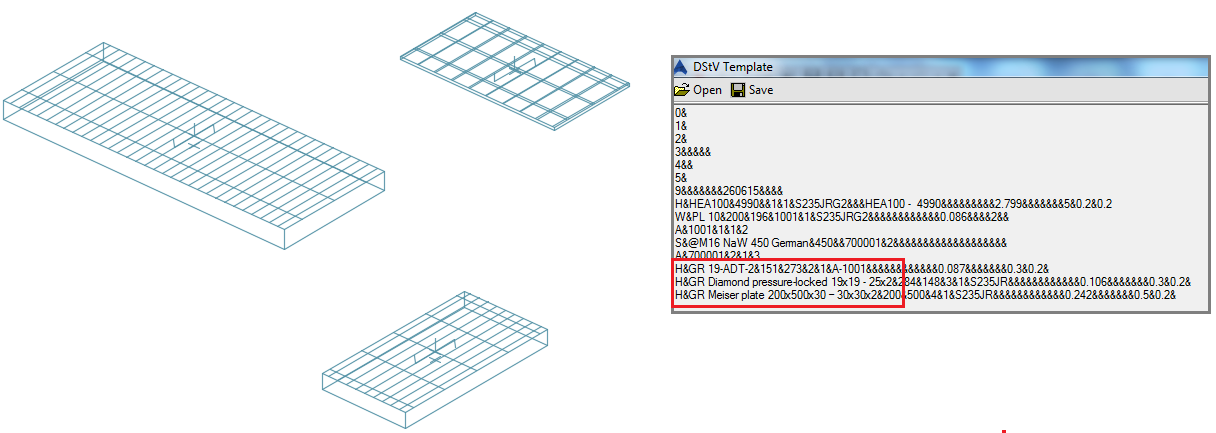

DStV BOM - available information about grating names
The name of a grating, as it appears in Advance Properties, can now be displayed in DStV BOM lists.

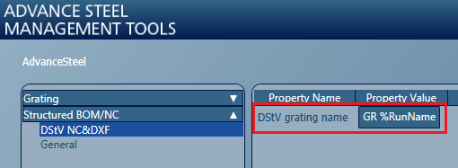

The default that controls this representation can be found in the Management Tools and it needs to use the %RunName parameter:
This DStV BOM configuration applies to all types of gratings (standard, bar and variable).
