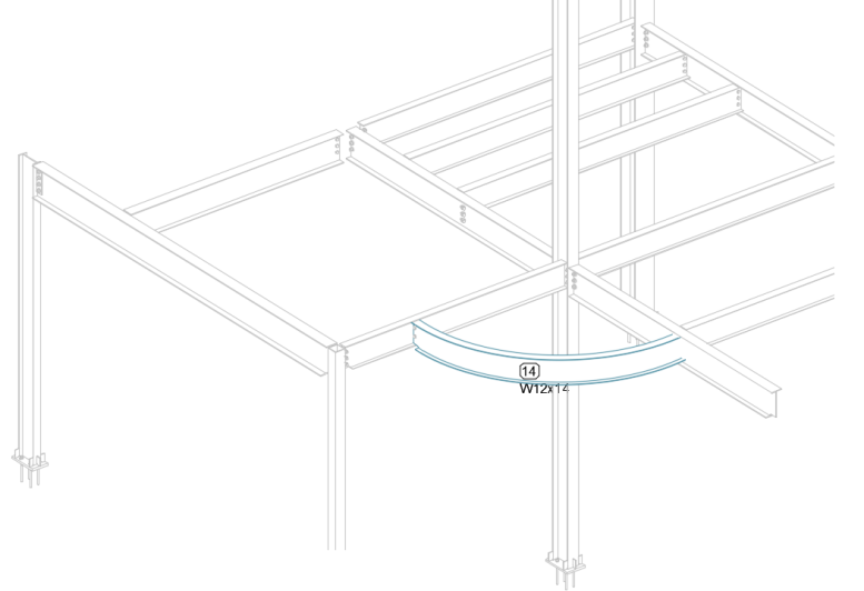

The representation for existing / environment elements on overviews was adjusted, together with a cleaner rule definition.

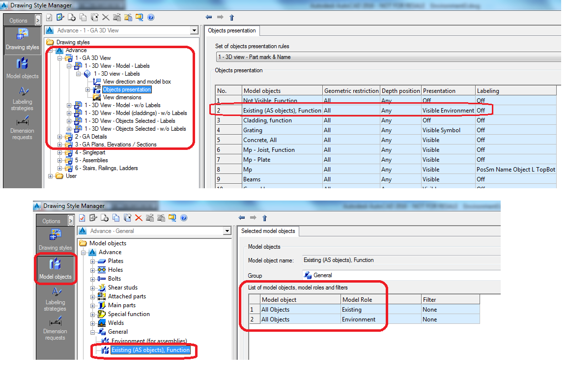

- Renamed the model object rule as
Existing (AS objects), Function, in order to make a clearer delimitation from similar model objects used for environment in assembly drawings.
- All the Advance Steel objects with
Existing or
Environment model roles will be shown with Environment presentation rule (grey color) on overviews (3D, plans, elevations).
- Added a record for the
Existing (AS objects) Function for all the overview drawing styles (GA 3D, GA Detail, GA Plans, Elevations / Sections).
