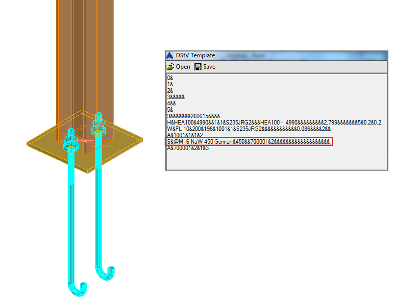

Information about anchors is now available in the DStV BOM.
The anchor names have the @ symbol placed in front of them and as an identification number they receive 70000 to be differentiated from bolts (that use 50000 and 60000).
To customize the displayed parameters, you need to access the Bolt category in the DStV BOM template.
