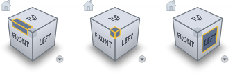

Switch to a preset view
Click one of the edges, corners, or faces on the ViewCube tool to reorient the view to a preset location.
The ViewCube tool provides twenty-six defined areas you can click to change the current view of a model. The twenty-six defined areas are categorized into three groups: edge, corner, and face. Of the twenty-six defined areas, six of the areas represent standard orthogonal views of a model: top, bottom, front, back, left, and right. Orthogonal views are set by clicking one of the faces on the ViewCube tool.
Use the other twenty defined areas to access angled views of a model. Clicking one of the corners on the ViewCube tool reorients the current view of the model to a three-quarter view, based on a viewpoint defined by three sides of the model. Clicking one of the edges reorients the view of the model to a half view based on two sides of the model.

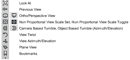

Display the NavBar
The NavBar is available for use when the ViewCube is selected as the View control in the Viewing section of Preferences > General Preferences. To display the NavBar, press + ..
