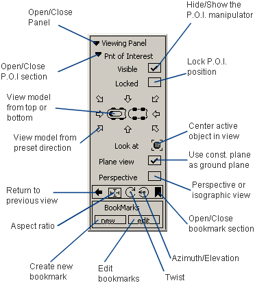

Display the View Panel
Tools
Of special interest are the following tools:
Look at
Clicking the Look at icon centers the view and zooms in on the selected objects (or all objects if nothing is picked).
Plane view
Checking Plane view lets you tumble about the currently active construction plane (that is, the construction plane is used as the ground plane).
Variants
As you work on a model, you typically change the camera view back and forth between two or more areas of interest. The view panel lets you “bookmark” these views of the model by saving them as variants. You can return to those views by clicking the name of the variant.
