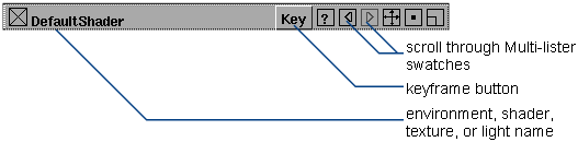

Multi-lister interface
Title bar
The title bar indicates the type of swatches that are listed in the Multi-lister. It also lets you control the display of swatches in the Multi-lister (text, small swatches, large swatches), and lets you close, track, and minimize/maximize the Multi-lister window.

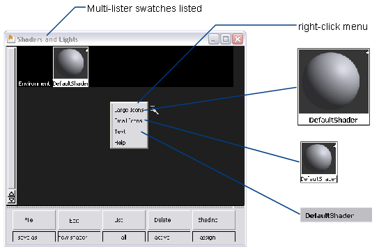

Swatches

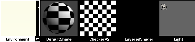

There are six different types of swatches used in the Multi-lister: environment, shader, texture, layered shader, switch shader, and light.
These six types of swatches are used to represent:
Swatches are listed in the following order: the environment, shaders, lights. Shaders and lights are listed alphabetically by name. Textures are listed next to the environment, shader, or light that they are mapped to.
All swatches consist of an image and a frame. The image represents the appearance of the environment, shader, texture, or light. The frame contains the swatch name and any icons.
The type of swatch image and the way that you use the swatch are different for different swatch types. All swatches, however, share the following features.

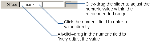

You can select a swatch by clicking on it. You can select several swatches by -clicking on them. By double-clicking a swatch, you open its Control Window. You can then edit any parameter for that particular environment, shader, texture, or light.
You can edit the swatch name by double-clicking on the name and typing a new name. You can change the resolution of the swatch’s image by click-dragging the white triangle on the right side of the swatch either up (higher resolution) or down (lower resolution).
If an environment, shader, texture, or light has a texture mapped to one of its parameters, the swatch will have an arrow in its bottom right corner. By clicking on this arrow, you can toggle the display of the texture in the Multi-lister.
If you have animated a parameter of an environment, shader, texture, or light, the swatch will have a diamond in its bottom left corner. By click-holding on this diamond, you can play back the animation of the swatch.

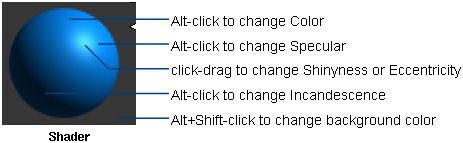

Shader swatches
A shader swatch uses a sphere to represent the appearance of a surface. By -clicking (Windows) or -clicking (Mac) on different parts of the sphere, you can open the Color Editor and edit the shader’s Color, Specular, or Incandescence settings. (By +-clicking (Windows) or +-clicking (Mac) on the background, you can open the Color Editor and edit the shader icon background color.) By click-dragging on the sphere’s highlight, you can interactively edit the shader’s Shinyness or Eccentricity value.
Note:
The shader swatch is only a preview image and may not exactly correspond to the appearance of the shader in a rendered image.

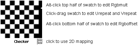

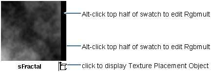

Surface texture swatches
A surface texture swatch displays the two-dimensional texture. By -clicking (Windows) or -clicking (Mac) on the top half of the swatch, you can open the Color Editor and edit the texture’s Rgbmult setting. By -clicking (Windows) or -clicking (Mac) on the bottom half of the swatch, you can open the Color Editor and edit the texture’s Rgboffset setting. By click-dragging anywhere in the swatch, you can interactively edit the texture’s Urepeat and Vrepeat values.
A surface texture swatch has two texture mapping symbols in its bottom right corner. By clicking on one of these symbols you activate either 2D mapping or 3D mapping.
The Stencil texture appears black in the Multi-lister until you specify its Image.
The File texture appears black with a small question mark (?) icon until you specify its Image. If the Multi-lister cannot find a File texture’s image file, the File texture appears with both large and small question mark icons.

A new, empty layered shader appears black, because the layers are empty. To add shaders to a layered shader, select one or more shaders from the Multilister window, then click Add. You can select multiple shaders by pressing the key while you select shaders.

An environment or solid texture swatch uses a two-dimensional pattern to represent the three-dimensional texture. By -clicking (Windows) or -clicking (Mac) on the top half of the swatch, you can open the Color Editor and edit the texture’s Rgbmult setting. By -clicking (Windows) or -clicking (Mac) on the bottom half of the swatch, you can open the Color Editor and edit the texture’s Rgboffset setting.
An environment or solid texture has a texture placement symbol in its bottom right corner. By clicking on this symbol you can display the texture’s Texture Placement Object in the modeling windows.
The Ball, Cube, Sphere, Projection, and Volume textures appear black in the Multi-lister until you specify an image file or series of image files for them. The sCloud texture always appears black in the Multi-lister; the shader it is mapped to displays the actual texture.

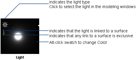

Light swatches

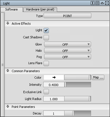

A light swatch represents a light as viewed from 10 units away with a 20 degree field of view. By -clicking (Windows) or -clicking (Mac) the swatch you can open the Color Editor and edit the light’s Color parameter.
A light swatch has a light type symbol in its top left corner. If the light has a force component, the light swatch will also have a force type symbol. If the light is linked to a surface, the light swatch will also have an L symbol. If a light’s link to a surface is exclusive, the light swatch will also have an E symbol.

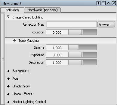

Control Window
The Control Window is sometimes referred to as the Environment Editor, Shader Editor, Texture Editor, or Light Editor.
The Control Window is the interface that you use to edit shaders, textures, lights, and the environment. You can also use the Control Window to access the Color Editor.
The Control Window contains a list of parameters for the selected swatch in the Multi-lister, and allows you to edit these parameter values or settings interactively. There are four different types of Control Window: environment, texture, shader, and light.

The title bar indicates the name of the active environment, shader, texture, or light in the Multi-lister. It also contains buttons or icons that let you set a keyframe for a parameter, or scroll through the Multi-lister swatches.

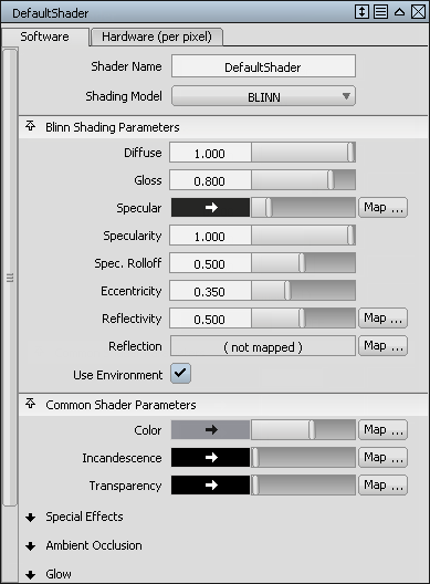

Parameters
Parameters control the appearance of shaders, textures, lights, and the environment. Each parameter has a name, which describes the parameter, and a field, which specifies (and allows you to change) the parameter’s setting or value. The Control Window contains several different types of fields: name fields, file name fields, toggle fields, menu fields, numeric fields, and color fields.
All the parameters are displayed on the Software tab; a selection of applicable parameters is displayed on the Hardware tab. The hardware tab is labelled either Per Pixel or Per Vertex, depending on the Shading Method selected for WindowDisplay > Hardware Shade.

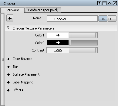

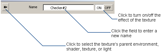

Name fields
Name fields let you change the name of a shader or texture by clicking in the field and typing a new name. Textures also have an arrow button on the left side of the name field, and ON and OFF buttons on the right side of the name field. The arrow button lets you select the texture’s parent swatch in the Multi-lister (that is, the environment, shader, texture, or light that the texture is mapped to). The ON and OFF buttons let you turn the effect of the texture on or off.
File Name fields and Browse buttons
File name fields let you specify a path and file name by clicking in the field and typing a file name. File name fields also have a Browse button on the right side of the field. You can click the Browse button to select a file using the File Requestor.
Toggle fields
Toggle fields let you set a parameter ON or OFF.

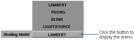

Menu fields
Menu fields let you select from a list of menu options by clicking the mouse on a menu button, and then releasing the mouse on the desired option.
Numeric fields
Numeric fields let you enter a number using either the keyboard or a slider beside the field. (You can also hold down the (Windows) or (Mac) key and drag the mouse in the numeric field to make fine adjustments to the value.) Each numeric field has a valid range (the range of values you can enter by typing in the field) and a slider range (the range of values you can enter using the slider). The slider range represents the recommended range of values for that parameter. The valid range is negative infinity to positive infinity for all numeric fields unless otherwise stated.
Some numeric fields also have a Map button (for example, Reflectivity).

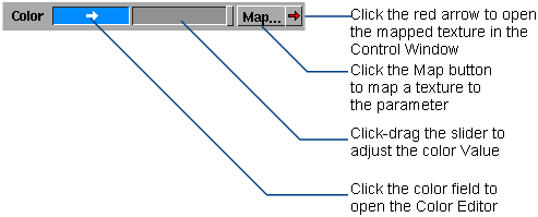

Color fields and Map buttons
Color fields let you specify the color value by using the slider, specify the color by clicking the color field and opening the Color Editor, or map a texture to the parameter by clicking the Map button. If you map a texture to a color field, a red arrow button appears to the right of the Map button. By clicking this red arrow you can open the Control Window for that texture.

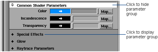

Parameter groups
In the Control Window, parameters are organized in groups. You can display or hide a parameter group by clicking on the group name.

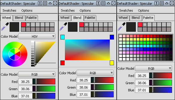

Color Editor
The Color Editor is the interface that you use to change the colors of environments, shaders, textures, and lights by that have a color field in the Control Window.
The color editor has three tabs that enable you to choose color based on your preferred method: a color wheel and triangle; a box for blending between four colors, and a palette of colors.

Sliders
The Sliders let you choose a color by dragging sliders or setting values for each color component.
Color Model
Controls whether the sliders use the HSL, HSV, RGB, or CMY color model.
Sliders
Let you choose a color by setting values for:
  • hue (0 to 360), saturation (0 to 1), and lightness (0 to 1)
  • hue (0 to 360), saturation (0 to 1), and value (0 to 1)
  • red, green, and blue (either 0 to 255, 0 to 1, or 0 to 100)
  • cyan, magenta, and yellow (either 0 to 255, 0 to 1, or 0 to 100).
    Note:
    You can choose the range for RGB and CMY sliders from the Options menu.
Active color
The active color swatch indicates the active color. The active color swatch updates interactively as you adjust the active color or choose a new color.
Color picker
Positioned directly beside the active color swatch is a color picker. Click this icon to change the cursor to a medicine dropper. Click the canvas to pick up a color from the active layer.

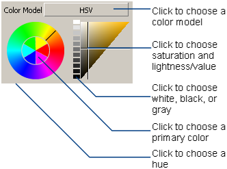

Color wheel and triangle
This area lets you choose a color using a color wheel and triangle.
Color Model
Controls whether the color triangle uses the HSL or HSV color model.
Color Wheel
Lets you choose:
  • a hue by clicking on the outer ring
  • a primary color by clicking on the inner disk.
Color Triangle
Lets you choose:
white, black, or gray by clicking on the column of swatches
a saturation and lightness/value by clicking in the triangle.

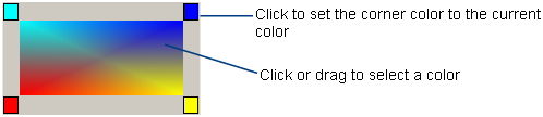

Blending box
The blending box represents a blend of four colors (the colors in the four corner squares of the palette). You can use the blending box to select a color by clicking or dragging anywhere within the box.
You can change the corner colors of the box by setting the current color (for example, using the sliders), and then clicking a corner square of the blending box.

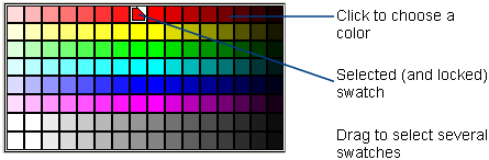

Swatches
The Swatches area lets you choose a color from a customizable collection of color swatches.

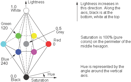

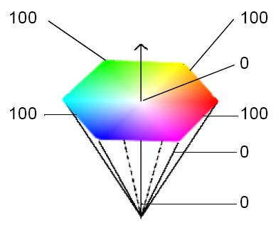

HSL color model
The HSL color model uses dimensions that are familiar to artists to specify colors: hue, lightness, and saturation. These three dimensions are represented by a double-hexcone.
There is one main difference between the HSL and HSV color models. In the HSV color model, both fully saturated colors (for example, pure red) and white have a value of 100%. In the HSL color model, fully saturated colors have a lightness (value) of 50% and white has a lightness (value) of 100%. In the HSL color model, pure white is perceived to be “lighter” than fully saturated colors (for example, pure red).
Hue
Hue is the quality humans use to distinguish one color from another. For example, red, green, and yellow are hues. In the HSL double-hexcone, hue is measured by the angle around the vertical axis. Red is at 0°, green at 120°, and blue at 240°.
Saturation
Saturation is the quality that distinguishes a strong color from a weak one. At 100% saturation, the hue is perceived at its strongest; 0% saturation is grayscale — there is no hue, only black, white, or a shade of gray. In the HSL double-hexcone, 100% saturation is at the perimeter of the hexagon, and 0% saturation is at the central axis of the double-hexcone.
Lightness
Lightness distinguishes light colors from dark ones. Black has a lightness of 0, and white has a lightness of 1 (and a saturation of 0). The bottom point of the double-hexcone has 0 lightness; this increases along the axis of the double-cone to 1 at the top point.
Note:
If the Lightness = 0, then the color is black, regardless of the values for hue and saturation. Similarly, if Lightness = 1, then the color is always white.

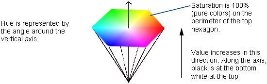

HSV color model
The HSV color model uses dimensions similar to the HLS color model: hue, saturation and (brightness) value. These three dimensions are represented by a single hexcone.
Hue
Hue is the quality humans use to distinguish one color from another. For example, red, green, and yellow are hues. In the HSV hexcone, hue is measured by the angle around the vertical axis. Red is at 0°, green at 120°, and blue at 240°.
Saturation
Saturation is the quality that distinguishes a strong color from a weak one. At 100% saturation, the hue is perceived at its strongest; 0% saturation is grayscale — there is no hue, only black, white, or a shade of gray. In the HSV hexcone, 100% saturation is at the perimeter of the hexagon, and 0% saturation is at the central axis of the hexcone.
Value
Value is the brightness value; it distinguishes light colors from dark ones. Black has a brightness value of 0%, and white has a brightness value of 100% (and a saturation of 0%). The point of the hexcone is 0% value; this increases along the axis of the cone to 100% at the top surface.

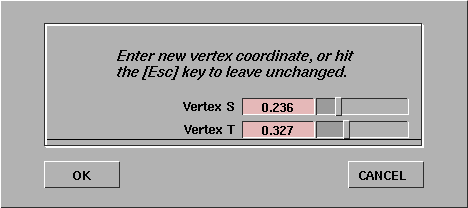

Set Vertex
Lets you enter numeric S and T values to re-position the selected vertex. When you select Set Vertex, the following dialog box is displayed.
You can also select the Set Vertex function by moving the mouse pointer over the Texture Placement window and pressing the S key.
