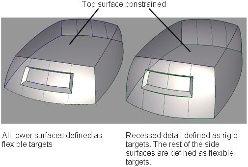

Flexible targets are surfaces, curves, or meshes that can have their shapes changed by applying transformations to the rig.
To add flexible targets, click this icon and select the geometry to assign as targets, then click Accept Targets. To remove targets, choose the Remove from Rig tool in the toolbox.
Rigid targets are surfaces, meshes, or curves. They transform (translate and/or rotate) along with the modification, but keep their shape; that is, the targets do not scale or shear.
To add rigid targets, click the icon and select the geometry, then click Accept Targets. To remove targets, choose the Remove from Rig tool in the toolbox.

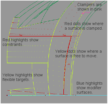

Clampers can help the software recognize regions of the model that should not be modified. These regions are usually defined by the constraints, but in some cases, the help of a clamper or clampers is needed. These regions can be identified with the help of the green and red dots that appear when setting constraints. These dots appear when Clamp Visualization is checked in the option box.
The region with green points is the region that is free to be modified. The region with red points is fixed, and will not change. To improve the visualization temporarily, pick a dot with the middle mouse button to make the colors more vivid.

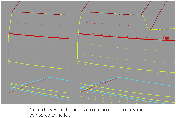

If this box is checked, this value enables you to visualize the sampling of the modifiers and constraints.
Eight tangent constraint points also appear at the corners of a box twice the size of the bounding box for the rig. These widely spaced tangent constraints help prevent exaggerated deformations for cases where there are few or no constraints.
If this box is checked, the Transformer Rig tool draws a visualization to improve understanding of the clamp regions.
