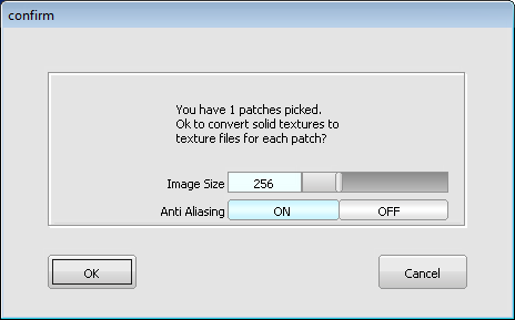

  3. Select Edit > Convert Solid Tex in the Multi-lister. A dialog box appears.
    The default value for Image Size is 256 pixels square. Image files are created and sized so that the Image Size corresponds to the longest dimension of the largest selected surface. If more than one surface is selected, the other image files are proportionally smaller. The valid range is 8 - 1024 pixels.

    Larger image files require more memory to render, and depending on the render specifications, may not noticeably improve render quality. Anti Aliasing is recommended in most circumstances, but Convert Solid Tex takes four times longer than if Anti Aliasing is OFF.

  4. Click OK. Information is displayed in the information line.
