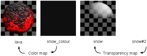

Snow texture
Use the Snow texture to give the appearance of snow, dirt, dust, or ash on objects.
To make snow appear on all objects in your scene, apply the Snow texture as a transparency map on a white shader, and then layer this shader onto other shaders. This way, the snow can have its own unique shading attributes.
Try combining a Fractal bump map with a Snow color map. The snow appears only on the peaks and valleys of the bump-mapped surface. For best results, set the Fractal bump map’s Amult and Blurmult values to a low number.
To simulate windswept snow, rotate the Snow texture by rotating the 3D Placement Object about a horizontal line.

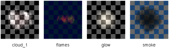

sCloud texture
The sCloud texture simulates clouds, but can also be used to create steam, smoke, or fire effects.
When using sCloud texture, remember the following:

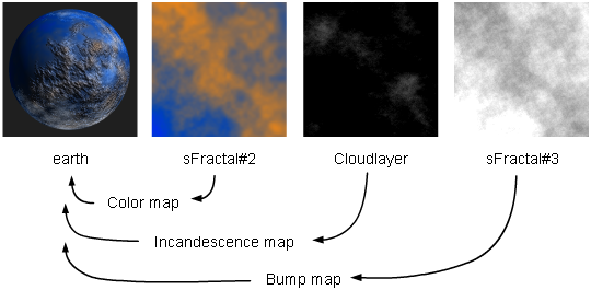

sFractal texture
The sFractal texture represents a three dimensional random function with a particular frequency distribution (a fractal) and can be used to create many different types of effects.

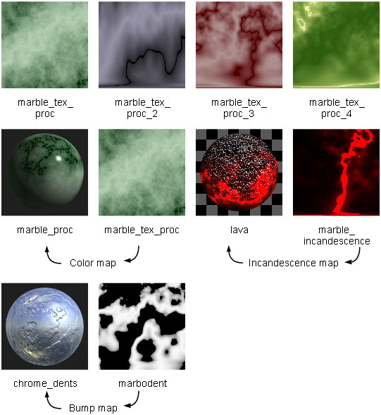

sMarble texture
The sMarble texture simulates marble: a vein of material sandwiched between layers of filler material, and diffusing into the filler material.

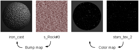

sRock texture
The sRock texture simulates rock using a random, three-dimensional distribution of two different types of grain material.

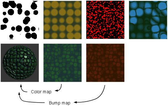

Leather texture
The Leather texture simulates leather, but can also be used to simulate other materials, including alligator skin, Styrofoam, and concrete, particularly when used as a bump map.
For many situations, an image file of real leather produces a good leather simulation. However, it is often impossible to map a file texture to a surface without distortions and discontinuity. Chord Length texture mapping may eliminate distortions, but it requires some effort and does not always work. In those cases, use the Leather texture.
The Leather texture uses a three-dimensional array of spheres to simulate two-dimensional leather. This is unlike real leather because real leather is a surface, not a solid. However, the Leather texture usually produces very realistic results. One exception is if the surface is deformed during an animation, because the surface appears to move through the solid texture. In this case, however, you can convert the solid texture to a File texture.

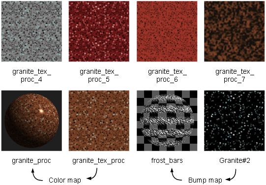

Granite texture
The Granite texture simulates granite using a random, three-dimensional array of three different types of spheres suspended in a medium. The Granite texture is like the Leather texture with three cell colors instead of one.
The Granite texture takes a long time to render. Convert it to a File texture whenever possible.

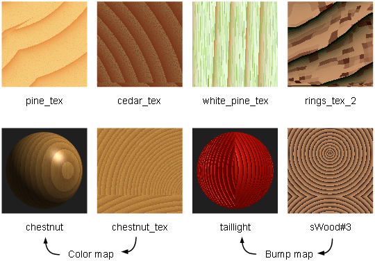

sWood texture
Use the sWood texture on surfaces to give the appearance of the object being carved out of a block of wood.
The sWood texture simulates wood by projecting a two-dimensional pattern. This pattern consists of layers or concentric rings defined by veins and filler. When you map the sWood texture to a surface, the surface appears to be carved out of wood. If you map the sWood texture to several surfaces, they appear to be carved from a single block of wood.
