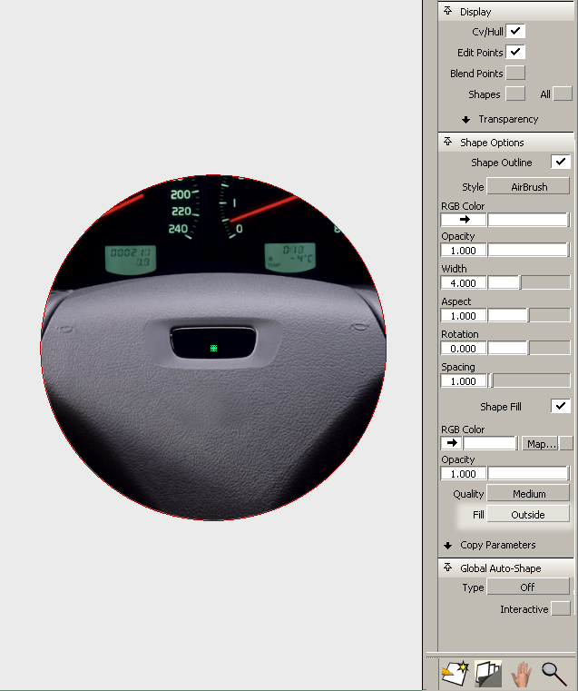

  4. If you want the fill area (invisibility mask) to be inside the curves., set Fill to Inside in the Shape Editor.
    The Shape Editor lets you modify several parameters of the Shape such as color, opacity, and so on.
    For a description of each option, see Windows > Editors > Shape Editor.

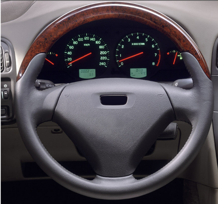

  1. Choose File > Import > Canvas Image to import the image you wish to edit, or paint on a layer. The image layer is automatically selected.

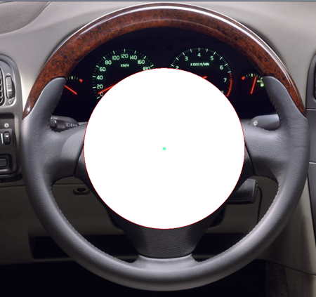

  2. Create a circle or whatever closed curve you wish. In this example we have created a circle and it’s highlighted in red.
  3. Select the Paint > Shape > Make Invisibility Mask Shape tool from the palette, then select the circle and accept the shape. Note how the image has completely disappeared inside the curve.

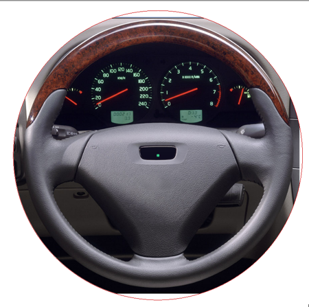

  4. In this example we want the inverse, so select the Fill Outside option from the Paint Panel.
  5. Now use the Alias Transform tools to enlarge and position the circle. Notice how the image is revealed as the circle is transformed.
    This technique provides a very fast and flexible way of hiding pixels from view and has major advantages over deleting part of an image layer. At any point, the curves can be repositioned and the layer will update to hide or show part of the image.

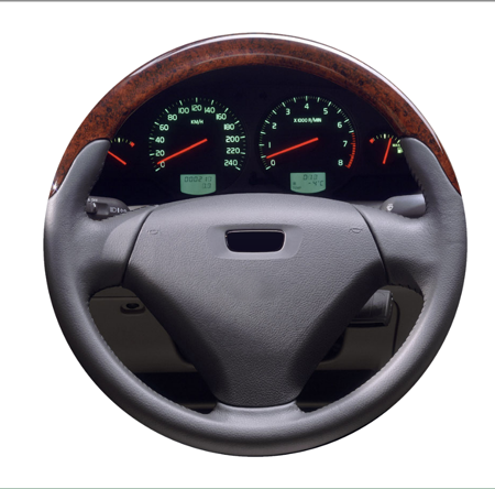

The image above was created using three curves and an invisibility mask layer where the fill texture was a gray scale ramp that provides semi-transparent pixels.
