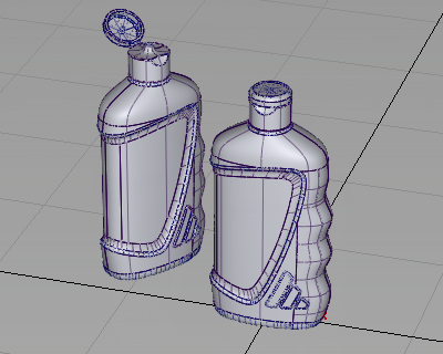

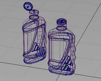

The file opens. The scene has two shower gel bottles in different positions, one with the cap open, and one with it closed.

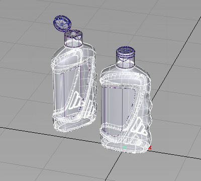

When setting up a model to render, it is useful to work interactively with a rendered view. For this exercise, use Hardware Shade to work directly on a shaded scene.
to open the Hardware Shade option window. The bottles are now visualized using the Hardware Shading.
The bottles are using the Default shader, which has the Blinn shading model. There are four types of shading models in Alias:

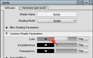

Below the resident Shaders section, there are four icons. Click the Copy Current Shader
icon to create a shader.
The default settings display.

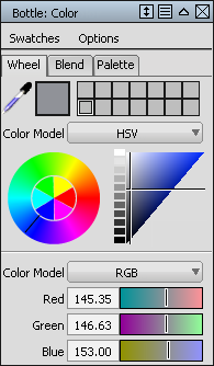

Now choose a color for the bottle.
Click the gray color chip to open the Color Editor.
The color chip updates, and the Bottle shader shows the new color.

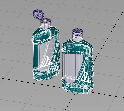

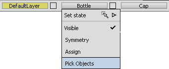

NowAssign the new shader to the bottle surfaces.
All the bottle surfaces are selected.

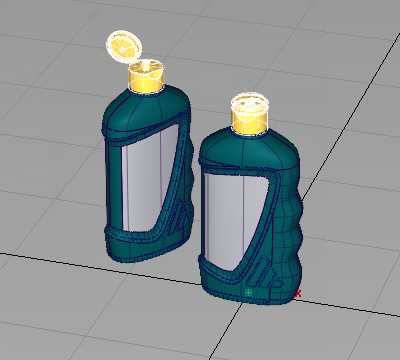

The bottle surfaces are now shown in the new shader color.

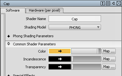

Now repeat this process for the cap shader.

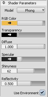

Change the Shader Name to Cap and the Shading Model to PHONG.
In the Common Shader Parameters section, choose a color for the cap.
Now, assign the shader to the cap surfaces.
A small bright highlight appears on the caps illustrating a glossy plastic material.
You can access the most common parameters for a shader in the Visualize Panel.
Now give the cap a more shiny appearance, and the bottle a softer finish.
The cap material looks more shiny.
