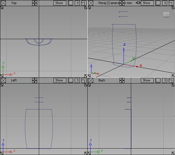

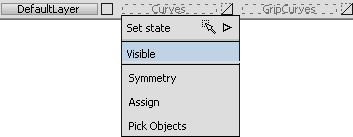

The main bottle curves are visible and placed on a layer named Curves.
Other curves are on layers that are not currently visible; you use these curves later in the tutorial.

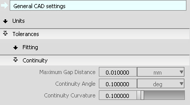

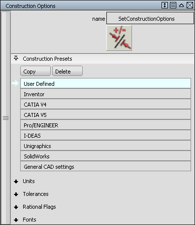

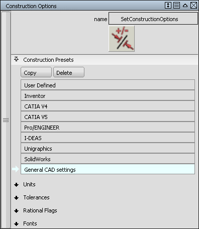

Before you start to create your model, choose the construction tolerances you want to work to.
The Construction Preset is set to User Defined. While this setting is suitable for rapid concept development, a more accurate setting is needed for data transfer to a CAD or Rapid Prototyping system.
To see what tolerances you are working to, open the tolerances section of the Construction Options window.
For future projects, you can choose settings that match the CAD system you are exporting data to.

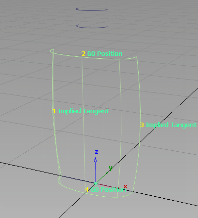

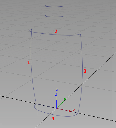

Start by creating the main bottle shape using a Square surface.
to open the option window.
In the Square option window, the four boundaries of the square are listed.
For boundaries, 2 and 4 change the continuity option to G0 Position. This continuity ensures that the square surface accurately matches the curves.
For boundaries 1 and 3, change the Continuity option to Implied Tangent. The Implied Tangent option ensures that the surfaces align smoothly across the center line.
You are prompted to select the four boundary curves. Click the curves in the order shown.
When you select the fourth curve, the square surface is created.

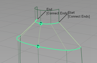

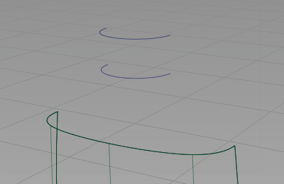

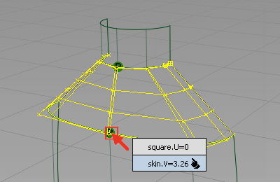

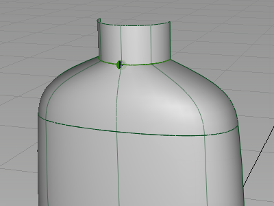

Blend the shoulder surface smoothly from the main body surface.
First create the shoulder as a simple skin surface from the body to the neck. Then create continuity between the shoulder and body, using the Align tool.

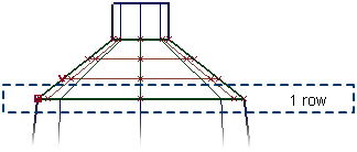

It is useful to understand how the Align tool creates the desired continuity. Observe how the CVs and Hulls change as you apply the Align tool.

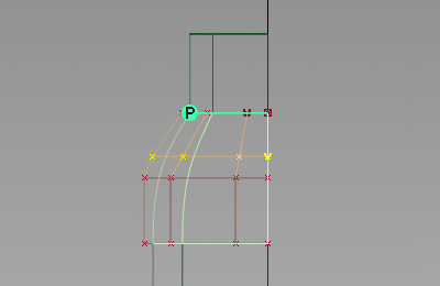

One row of CVs is aligned to the other surface. Positional is the default continuity when you create the skin surface.
Two rows of CVs are aligned to the other surface.
Three rows of CVs are aligned to the other surface.

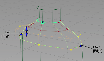

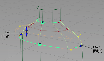

First, create the shoulder surface with positional continuity.

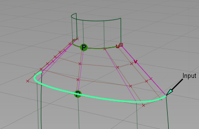

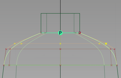

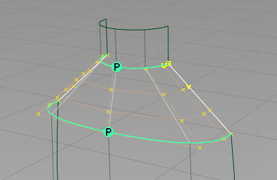

Now use the Align tool to modify the shoulder surface, making it Tangent to the body surface.
First, delete the Construction History of the shoulder skin, to allow it to be modified.

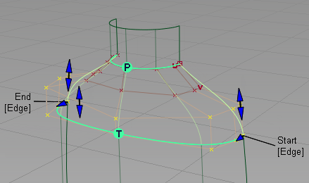

You are prompted to select the boundary of the surface to be aligned (the input). This surface is the skin surface you created for the shoulder.
The selected edge is highlighted and labeled as “Input”.
You are prompted to select the object to align to (the master).
The top edge of the body surface is selected automatically.
The CVs of the shoulder surface are modified to align the shoulder to the bottle surface with tangent continuity, as indicated by the T on the green indicator.

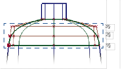

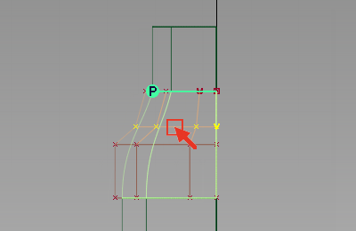

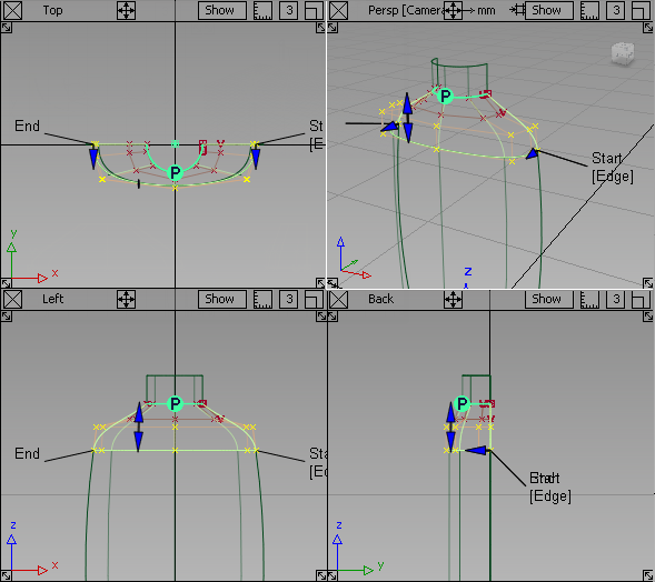

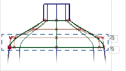

Now modify the character of the shoulder blend by moving and scaling the CVs and Hulls.

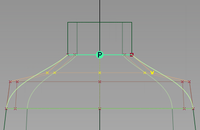

In the Back window, select the hull of the second row of CVs from the top by clicking the red hull line.
The pivot point for the CVs defaults to the origin, so the CVs scale correctly.
Set the Continuity option to Curvature in the Align tool to adjust the third row of CVs and get an even smoother transition.
