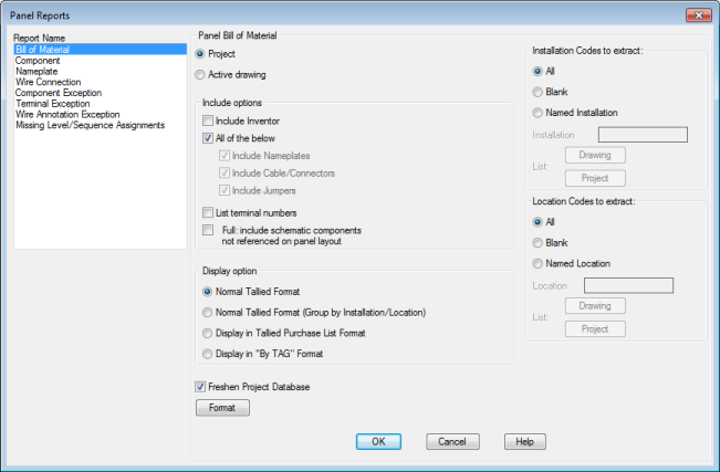

Panel Reports Dialog Box
Generates a report extracting information from panel components, nameplates, and terminals.

The following options are displayed.
Note: Options vary based on the report name selected.
Report Name
Specifies which report to run.
Note: The Missing Level/Sequence Assignments report will not be available in future releases.
Report Scope
Specify whether to process the project, the active drawing, or selected objects. If project is selected, some reports provide an option to select which drawings to process.
Installation Codes to Extract
Filters the information extracted for the report based on installation values.

Freshen Project Database
Specifies to update the project database with the latest drawing information.
Redisplay Last Run
Displays the previously extracted report.
Format
Opens a dialog box where you can select a format (.set) file. Use a format file to predefine the fields to include, the field order, and more.
Bill of Material Report Only
Include Options
Include Inventor
If your project is linked to an Inventor assembly, this check box is enabled. Specifies to include the electrical parts from the linked Inventor assembly in the report. Linked devices that are represented in both an AutoCAD Electrical drawing and the Inventor assembly are not duplicated in the report.
All of the Below
Specifies to include nameplate, cable, connector, and jumper information in the report. Use the individual check boxes to include or exclude any of these.
List Terminal Numbers
Lists each individual terminal in the format strip-ID:terminal number. Otherwise terminals from the same strip are combined into a single entry with a quantity.
Full
Specifies to include all schematic component information not found on any panel layouts in the report.
Display Option
Normal Tallied Format
Combines and tallies components that have the same catalog information. Subassembly items and multiple catalog values are reported as line items directly following the main catalog item.
Normal Tallied Format (Group by Installation/Location)
Combines and tallies components that have the same catalog, installation, and location values. Subassembly items and multiple catalog values are reported as line items directly following the main catalog item.
Display in Tallied Purchase List Format
Each catalog value is reported and tallied as a single line item. Subassembly items and multiple catalog values are reported as separate line items.
Display in By TAG Format
All instances of a given component tag or terminal tag are reported as a single line item.
